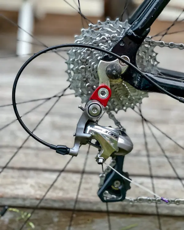

Update on the pig. Had to shorten the chain, but once it was off I ended up replacing the derailleur with a 105 version on an extended link.
Then spent what seemed like ages fettling the shifting, front and rear. And of course, when the front derailleur had been lowered, it needed a new cable, so that was fitted and everything tied up again.
Once everything was back together, I took it out for a ride and within a km, the pin I'd replaced when shortening the chain worked its way loose. Luckily I was ready for it so it didn't go through the derailleur and wreck it.

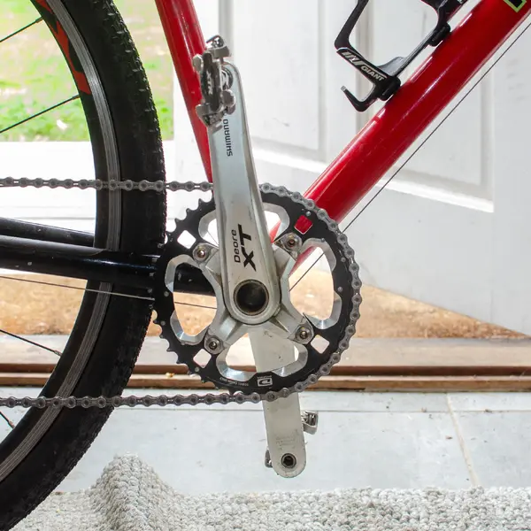

If you've got to use one... I'm surprised the chain doesn't rub on the bottom of the f mech cage onthe small chainring in all but 1st gear
Its a rather special set up of full on experimentation & the front mech is basically useless so wil only change down but not up as to big a gap unless i add a middle ring probably 54T would do.If you've got to use one... I'm surprised the chain doesn't rub on the bottom of the f mech cage onthe small chainring in all but 1st gear![]()

Won't that derailleur run that 32? cassette without the drop link, just a bit of b-adjust?
The drop link makes shifting worse because the top jockey is pulled further away from the sprockets.
