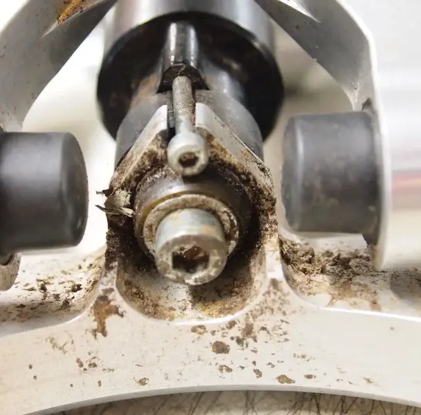

Mk2 lower end, with anti-rotation screw and paired elastomer bushes either side of the location plate on the linkage, no pivot as such. (excuse the mud :) )

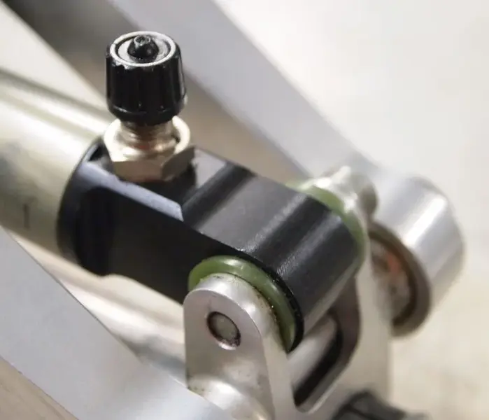

Mk2 upper end. M6 bolt through elastomer bush, no bearing:

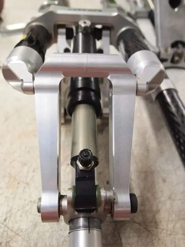

Tight fit through the upper linkage Mk1, shaft is only 24mm, shock body is 35mm at its fattest:
Slightly better on the Mk2, 44.6mm clearance between arms:
