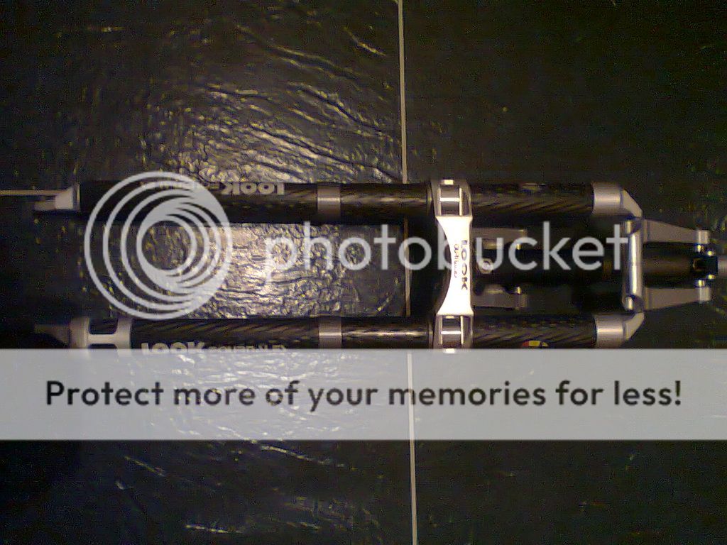

Sorry for the poor pics ,
This is the fork i have now , one question , am i right thinking that the lower Ali rings below the lower brace is for the brake bosses ? if so do you know of any for sale . Welcome to family life and the land of DIY , thats the bonus of being 60 and kids leaving home . :D
You are correct about those ali rings being the mounting interface for the brake bosses. I do happen to have a spare set of those (NOS) if you're interested. Have to do some digging around my stash...
