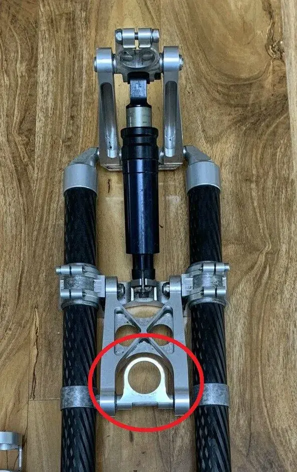

Great nice condition Mk3 fork, and including the rare (non-ISO) disc tab fitting, but...
It is missing the clamp-on canti mounts and a few bolts, but far more importantly, it's unusable without the specific integrated steerer tube and the screw-on top section that the stem clamps to:
This is a Mk2, but the arrangement is the same.
It's not easy to lose this part, as it is press fitted into the bottom yoke, that is included 🤔
Could probably get something machined to work, but it's far from being a complete usable fork. :confused:

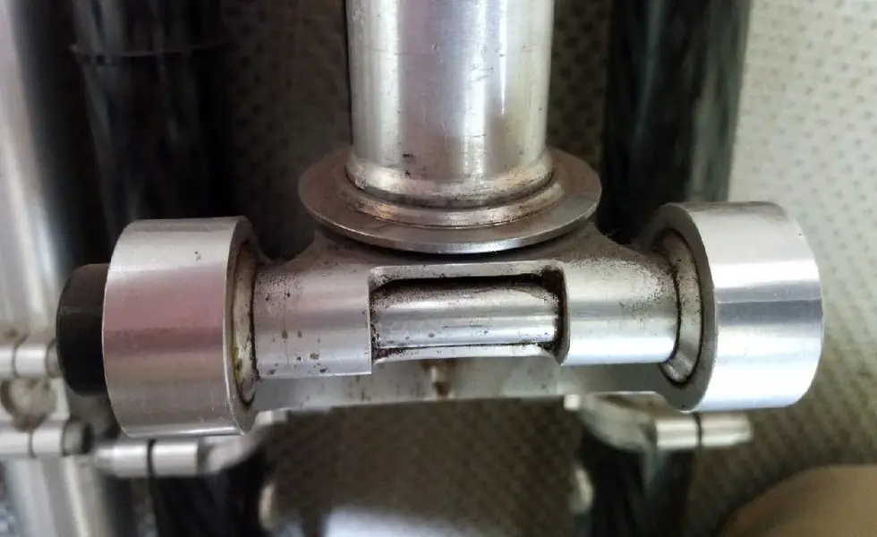

OK, swapping out some Mk1 parts will work. :)
The Mk1 steerer is compatible with the Mk3 yokes, but would need pressing into the Mk3 yoke, rather than simply swapping yoke/steerer units, since the Mk3 yoke itself is different.
Mk1, narrow, 2-bolts. Mk3 wider, with a bolt-through + nut:
The press fit into the both yokes is the same, along with the screw-on top section (My Mk1 has been cut down).
The Mk3 steerer is machined with a step down below the top bearing seat, but that will just save some weight, the contact points are the same diameter:
