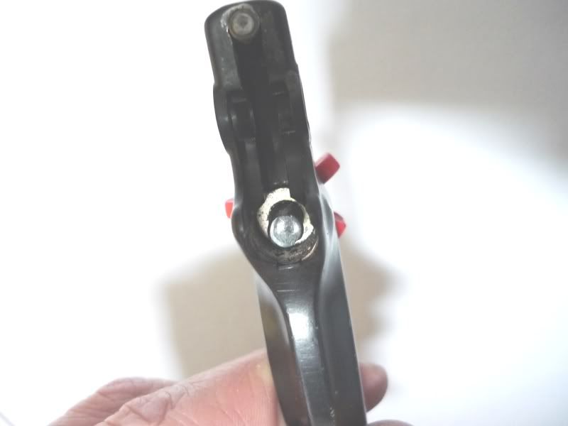

I thought I was fairly clued up on these things, but I've come to a halt on a full strip down.
My intention is to rebuild and paint them, but I can't figure out the lever arrangement.
I have taken everything apart, but cannot seem to remove the brake pad adjuster knob. It turns in its hole, but doesn't seem to move up and down as you'd expect. It has a tiny washer attached at its base, which turns with the knob, when you rotate it.
I noticed that the thread on the inside of the knob is flat on one side, but doesn't appear to line up with anything.
How the hell do I remove the adjuster knob, and assess why it doesn't work?
I'll include a picture in a minute....

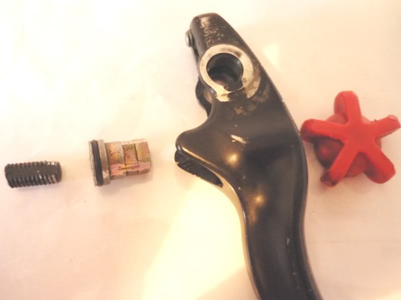

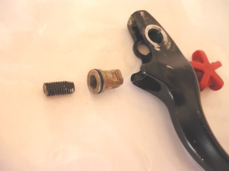

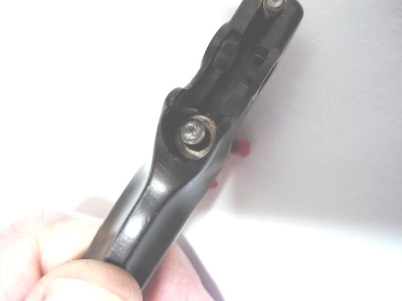

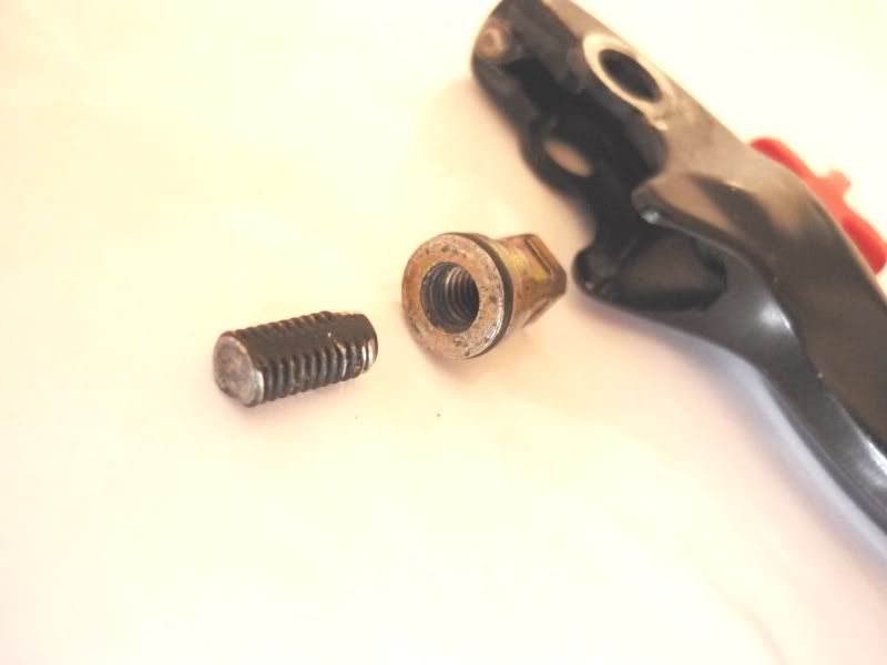

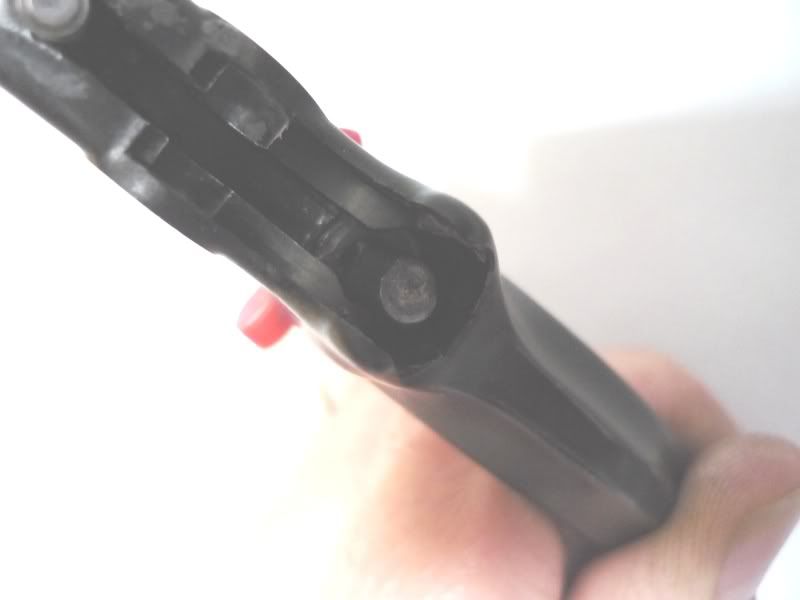

The following are the close up shots of inside the lever, and the adjuster thread.
The red adjuster should just pull off (you may need to use a small screwdriver to lever it a bit) and the you should be able to remove the adjusting pin itself. If it doesn't move in and out when you turn the adjuster then it's probably threaded. This is a common problem with these due to heavy handed people continuing to try to turn them once they've stopped. :roll:

The Red adjuster knob is a cap over a threaded bolt? Held in place with a washer??

Hold the small thread on the inside of the lever with long nose pliers and turn the knob anti-clockwise. It will remove the male threaded barrel from the female barrel with the adjuster knob on. The adjuster knob should be carefully prized off with a small screwdriver. Then the female barrel will push through to the inside.
I'm off to the bike shop in a minute to visit their Magura spares box, but I don't think i'll find the adjuster threads. I've photographed what I can see so that others may arm themselves before going for the total strip down, plus I guess a few people will need to replace the threads as ham fisted individuals over tighten them.
