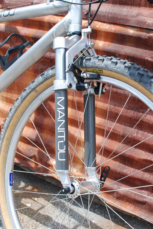

I bought a gary fisher pro caliber in california in '92 and got this fork installed instead of the standard unicrown it came with
First generation Dough Bradbury Manitou Fork - 1990
Second generation Doug Bradbury Manitou fork - 1991 (pictured with custom brace)
file.php
Answer Manitou 1 - 1992 (probably some could get them in 1991)
Answer Manitou 2 - 1993
Answer Manitou 3, 4, & EFC... new one each year after that, more or less

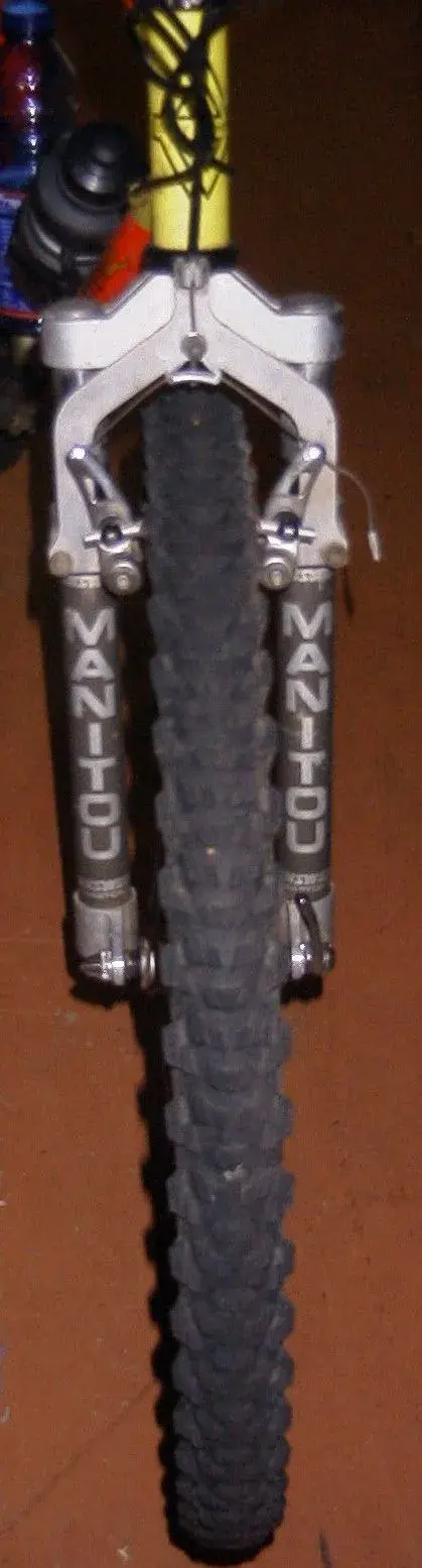

Ive an Answer Manitou Mach 5 FS Bulge 1997. Nice condition too :D
The bike is all original spec, so date it at that.
