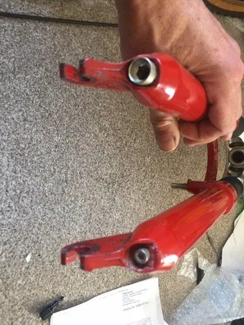

I’m trying to remove the lower legs so I can get them blasted and coated but can’t seem to get them off. Has anyone dismantled a set before? Reading the instructions it says fully compress so the springs don’t turn, I’ve removed the Allen bolt that’s on the outside (5mm one) but the one on the inside of the leg just seems to keep spinning (it can tighten up though).

Did you remove the silver alloy allen bolt (7mm ish) that the plastic adjuster pushes into?The upper one on the picture.Sounds like you may have been trying to undo the smaller 4/5mm one through it's centre.That's your rebound adjustment.
That’s exactly what I’ve done - popped home in my lunch and fork legs are now in my boot ready for coating.
Thanks for your help mate
