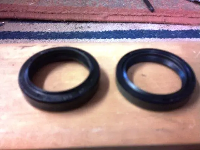

The seals on my bombers needed renewing, having looked on the various websites for a replacement set I struggled to justify forking out (sorry about the pun) on a set at £20 for a set of forks that cost £25, so i had a look for an alternative.
Here's what I've found so far (the wipers seals are next) Aprillia SR125 fork seals, 30mm x 40mm x 7mm on the right. the Bomber original is on the left and is 8mm thick. these were just £6.15 delivered
a much more wallet friendly price.
I'll get the forks rebuilt and let you know how they go.
