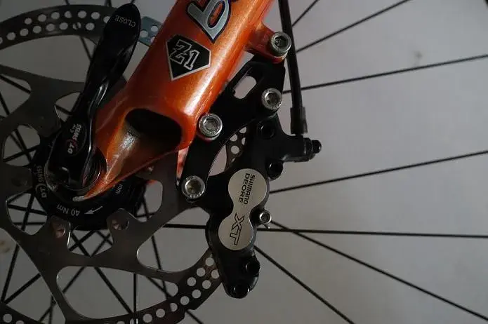

02gf74 Old School Grand Master Feedback View Dec 14, 2013 #7 Z1 forks have non standard tab - is not IS. Not sure if you buy an off-the shelf adapter but there are poelpme making them. I had one made up by memebr on here, not sure if he is still doing them. Attachments z1adapter.webp 24.6 KB · Views: 216
