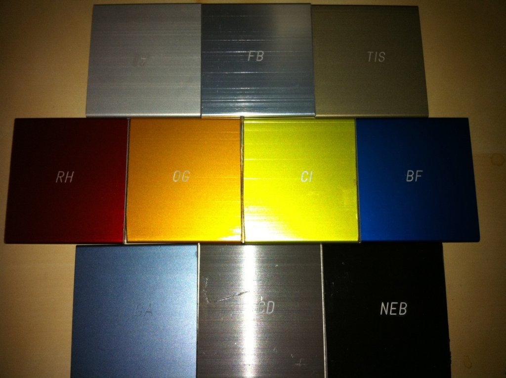

TIB is the finish bronze/gold finsh
SBP is the Silver finish.
Advantage of the SBP is you don't have to go through the anodising as much to get to metal ;)

TIB is top right colour and SBP is top left colour

Yep, as said, colour difference only.

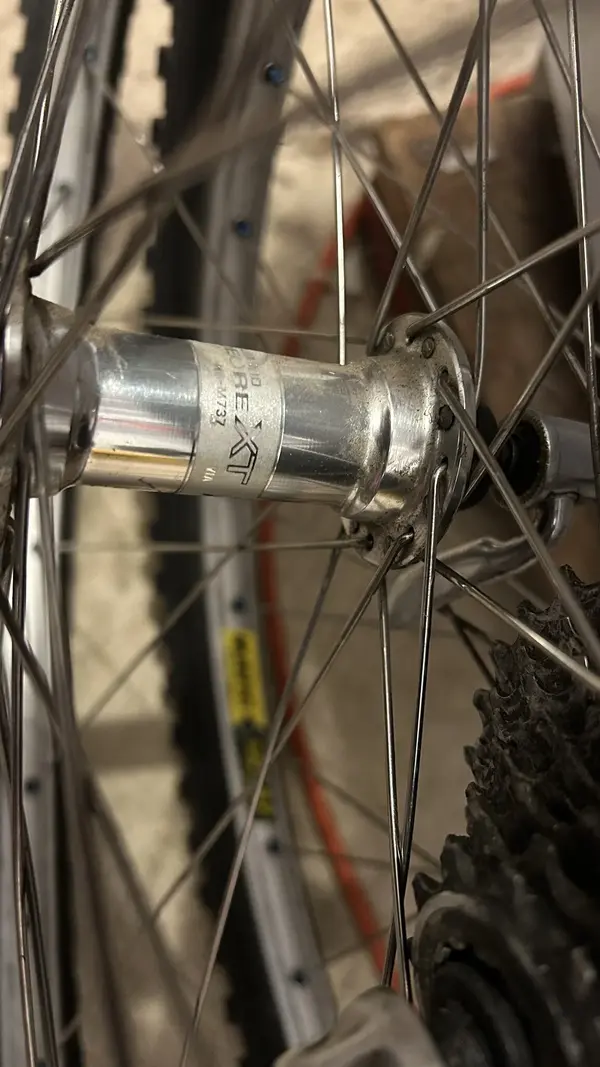

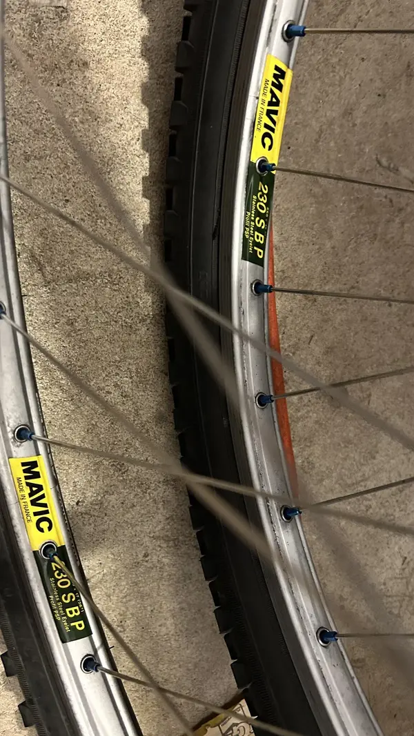

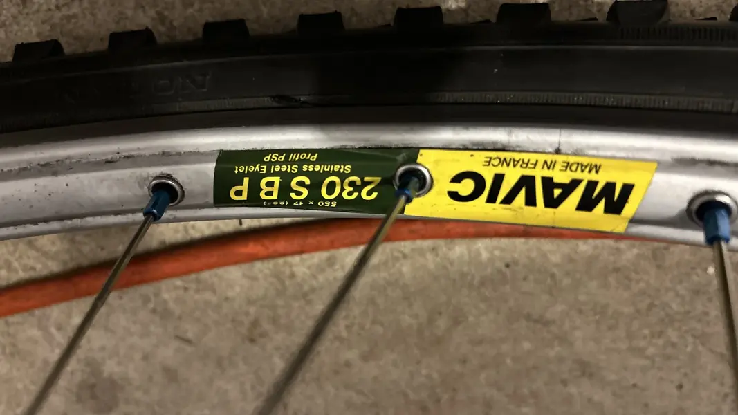

picked up a set tonight
they are light
