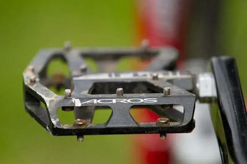

best looking for me are Acros A-Flat Pedals with 3xx gr
price: ~66€ and with titan 16x€

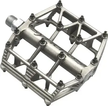

For maximum style points the Syncros Mental pedals. stainless steel construction= indestructible but heavy (really heavy).

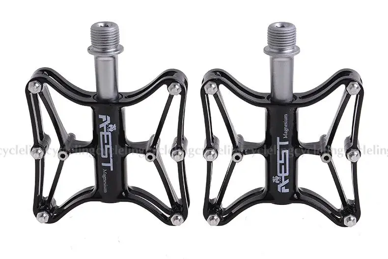

For minimum weight I use those AEST magnesium pedals with Ti spindle. Crazy light, reasonably priced but I don't know if they're any good for punishment (I bought them for about 50$ off e-bay so I thought if I ruin them off-road I won't be too sad but I use them mostly on the commuter bikes.)
