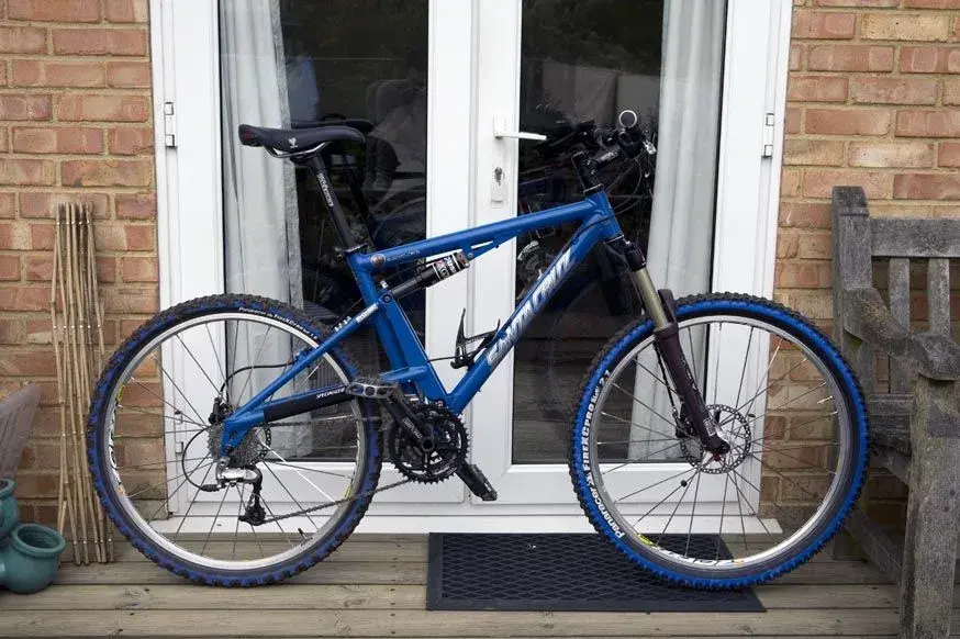

I run some RS Revelations Dual Airs on my '97 Heckler - mainly because I got them stupid cheap s/h. They come set at 130mm but I think you can change travel internally to 115mm with a spacer. They feel fine and I think the Heckler can take the slacker angle OK strength-wise. Feel fine riding XC, great DH but not great up hills when the front end can feel very light (would be great if you could lock it towards the bottom of the travel instead of the top!). I run a fair amount of sag (and more - ve pressure which sucks travel down a bit) but will prob get them taken down to 115mm when I get them serviced.
