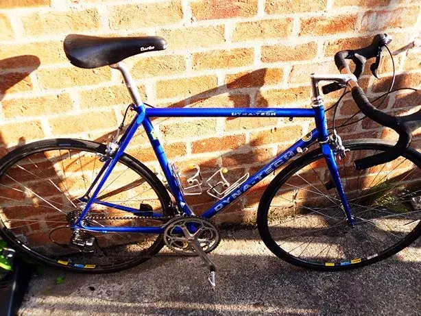

from 8sp to 10sp no problems, rear was already 130 so very easy. kept the 600 tri cranks/chainrings as they actually weigh less that modern ones (yes i weighed them/ no BB just the cranks and arms) and look much better IMO.

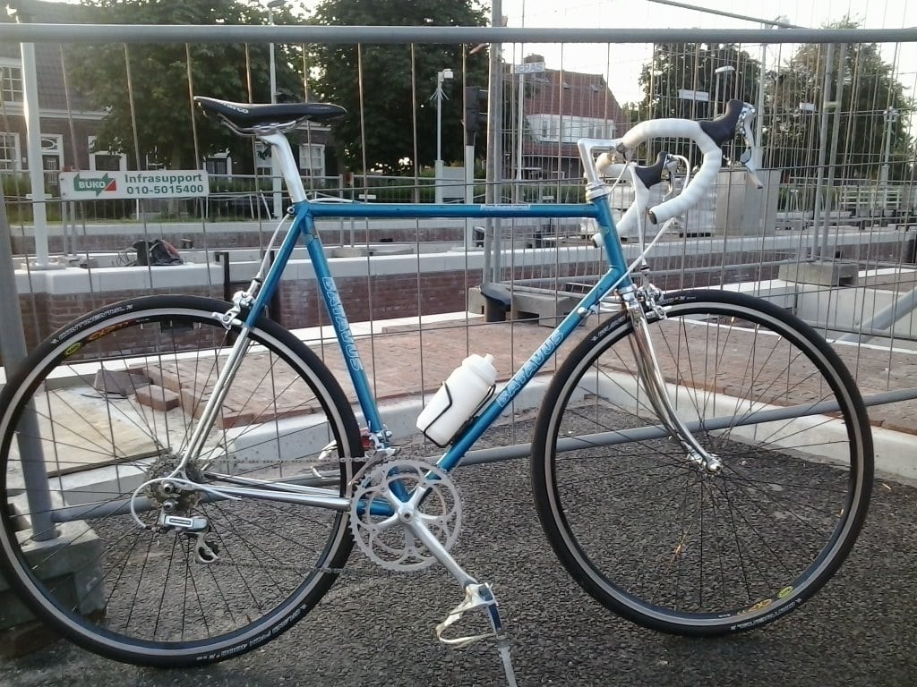

Batavus Professional with Dura Ace:
