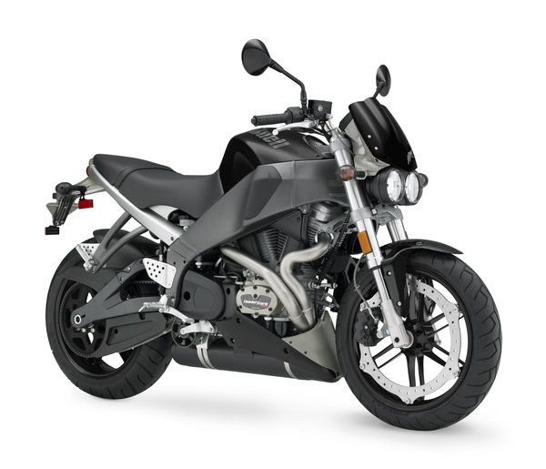

Seen some stuff like that before on some custom chopper style bike, they look really cool
Buell Firebolts and Lightnings (optional) came with single sided perimeter rotor disk brakes. The one in the post above is a modded dual disk set-up by someone at Barber Racing.
Seem to remember the Elf Grand Prix 500 bikes using them too . Dunno what Rocket Ron was thinking when he signed for them ! :facepalm:
