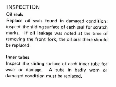

Theres no mention of bore spec for fork lowers in either the Suzuki service manual or the Clymer manual (not the same as the workshop manual the dealers get, I know). I think you're right, the original option would have been to get new lowers. Plenty of info on cylinder bore and master cylinder bore service limits. This is the section in the service manual:
No mention of the lowers, anywhere.
I'm not going to lose too much sleep on this. This rabbit hole leads to fitting newer compatible forks such as bandit 600 where you can still buy new lowers...but that means bandit wheels, brakes etc. I don't want to go there, fitting a more modern front end...that means matching it at the rear which is a much larger headache with chainline and swingarm clearance. And bandits are largely ragged and poorly maintained from what I see for sale.
