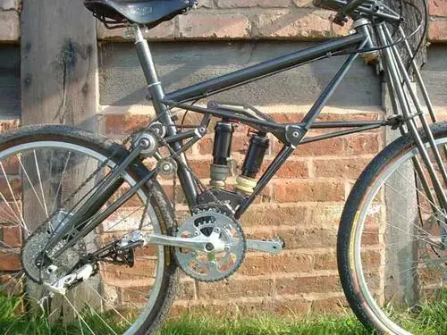

Come on now Graham, play nice; the suspension is connected, it's an interesting comparison. I wonder if Muddy Fox tried linking it up the 2CV way around to see if it worked on a bike.. worth a try.
samc":3kh6qsdq said:
:facepalm:
Sorry. The abrupt nature of my reply was to do with it was being late and that I had other things to do. It was not that the History Man's 2CV comparison was not both interesting and relevant.
However, due to the very high centre of gravity of a bicycle, linking it like a 2CV throws up a some big issues with front and dive under braking and rear end squat when pedaling.
It can and has been successfully done on the Highpath built Toptrail, but only with the addition of a complex anti-dive front brake and an anti-squat rear drive chain.
Checkout the videos on the Toptrail site.
http://toptrail.co.uk/
Or here for technical info:
http://toptrail.co.uk/docs/MB_suspensio ... 050606.pdf

^ that's awesome! If they could make it weigh less than the Forth Bridge that'd be amazing, but I guess if it's sold as a DH bike it doesn't matter so much.
Be good to see it in comparison with a decent long-travel full suspension bike though, rather than the halfords nonsense and the ancient RTS they compare.
Yes! A prime candidate for a monocoque carbon fibre structure. But this suspension system is more complaint then any others that I know of so, without a major re-tune, it is not really a candidate for big hits like those in downhill racing.
From what I understand from talking with its maker, is the it is more of an ultra comfortable, lazy man's trail bike, as the suspension does all the hard work for you. All the rider needs to do is pedal and steer. Whilst the "Interactive" design is all about improving rider comfort without wasting any pedaling energy in the process. Not unlike the later Renault Sport/Giant' NRS no sag suspension system.

Er, no! - not worth a try, because it can't possibly "work" - just as it didn't work on the 2CV, which was infamous for its instability.
I'm reminded of an in-depth technical article in 'Autosport' - a candid critique of the anti-roll function on F1 cars. It simply stated the scientific fact - "This is the opposite of what is required." - yet all the 'experts' still follow the same design convention!! Smart design doesn't need ANY anti-roll, because the car can't roll in the first place!!
So, every car on the planet (lacking 'active' suspension) suffers from an entirely unnecessary ride/handling compromise, which can be eliminated by simple passive designs that actually DO work.
Being charitable, I'd say that the Toptrail project is barking up the wrong tree. Being brutally honest, it's just 'barking'.
Two springs on a bike is plain wrong, just as four springs on a car is an unworkable design premise. The compromise is inherent and incurable. As my proof-of-concept car model demonstrates, if you separate the chassis levelling function from suspension compliance all the problems disappear. QED.

You may be confusing the 2CV with the swing axles on the original VW beetle? The 2CV was only unstable when going backwards.

Yes any car with a centre of gravity that is dissected by a plane that also passes through the centre of the wheel axis would not roll. However that means either very low slung car bodies as in F1, or very big wheels.

The Toptrail designer Adrian Griffiths, is a top automotive suspension designer. As such I think he deserves a more detailled critique than simply describing his design as "Just barking".
