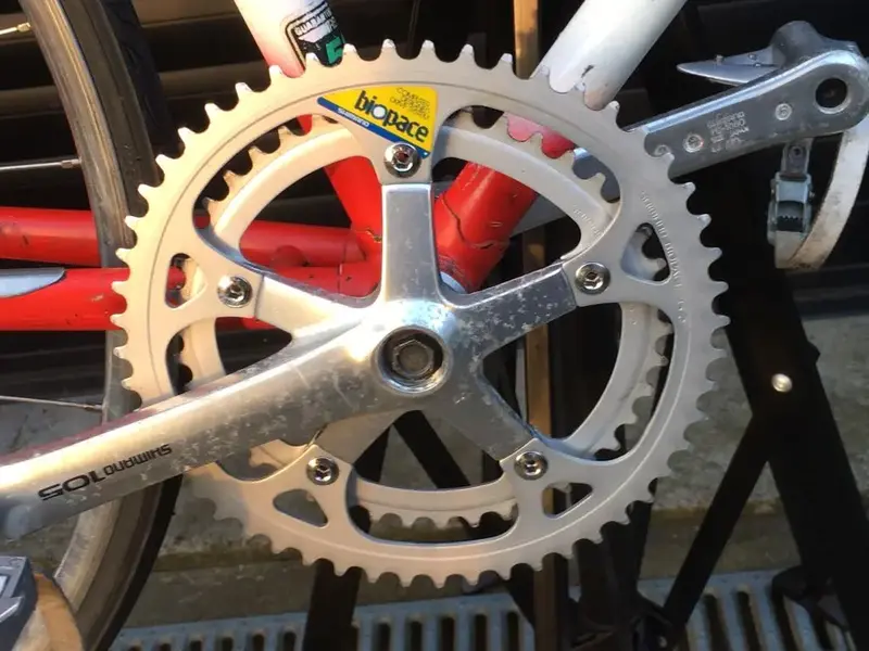

I’m 90% certain that’s got a Uniglide cassette on it because I can see the ends of the splines on the freehub. If you don’t have shifters already, any friction shifter will work, or an Exage 6-speed indexed shifter will work if you use a Shimano SIS compatible rear derailleur. Basically any Shimano road derailleur from about mid 90s up to 10-speed 105 5700 series will index correctlyI have bought pair of wheels, not grey rims but they look correct and the correct rear axle width.
