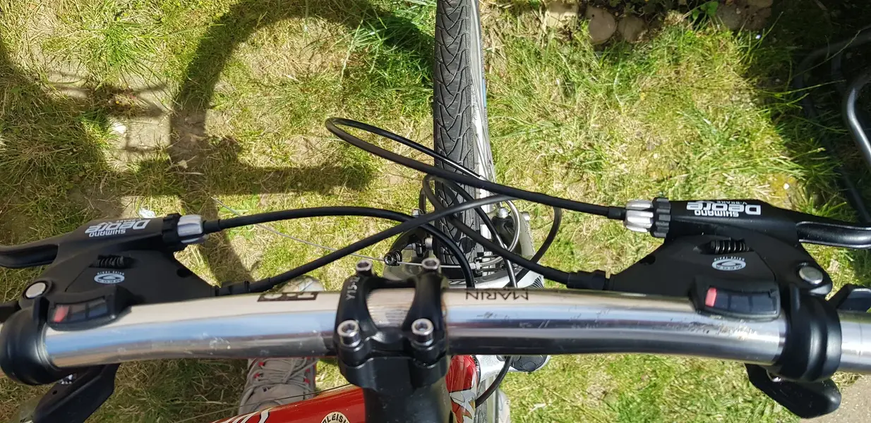

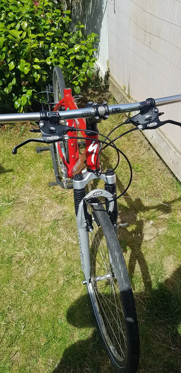

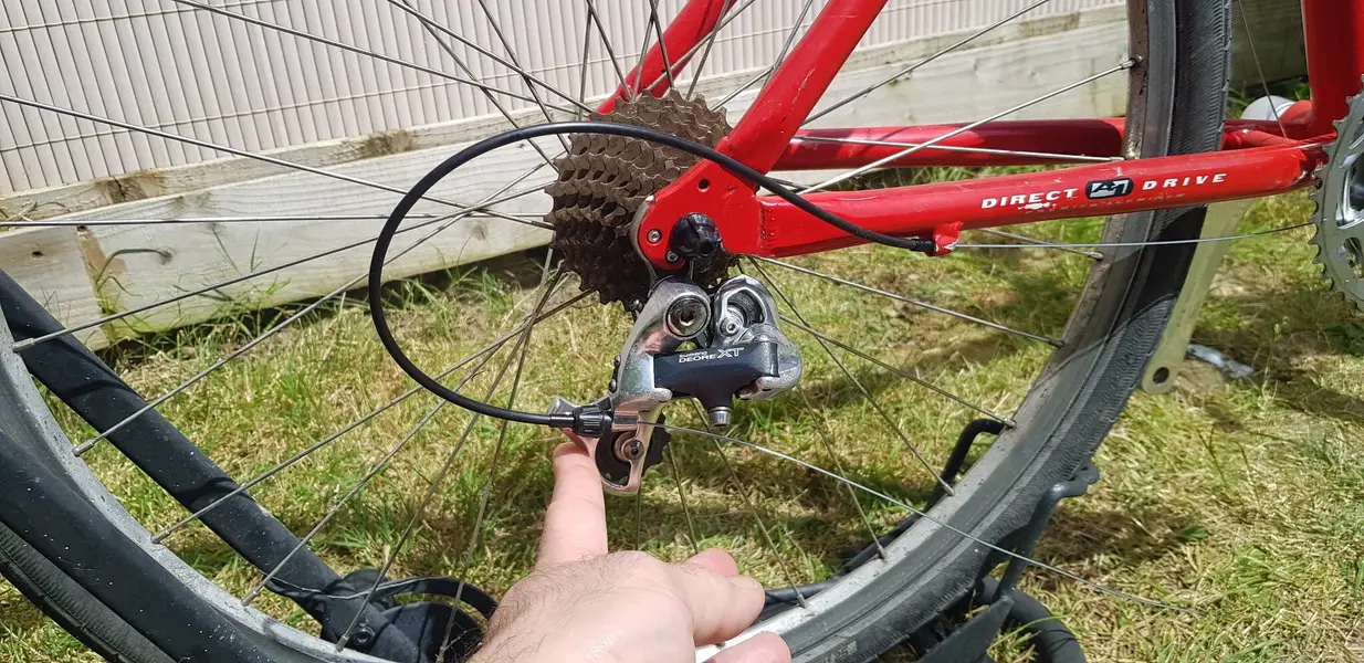

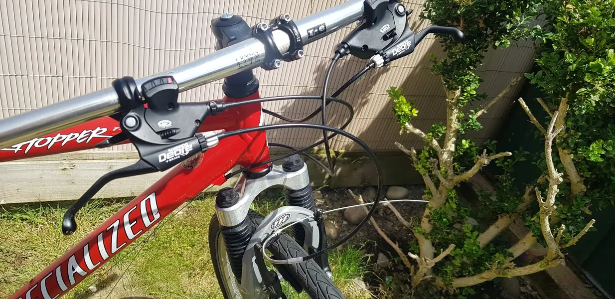

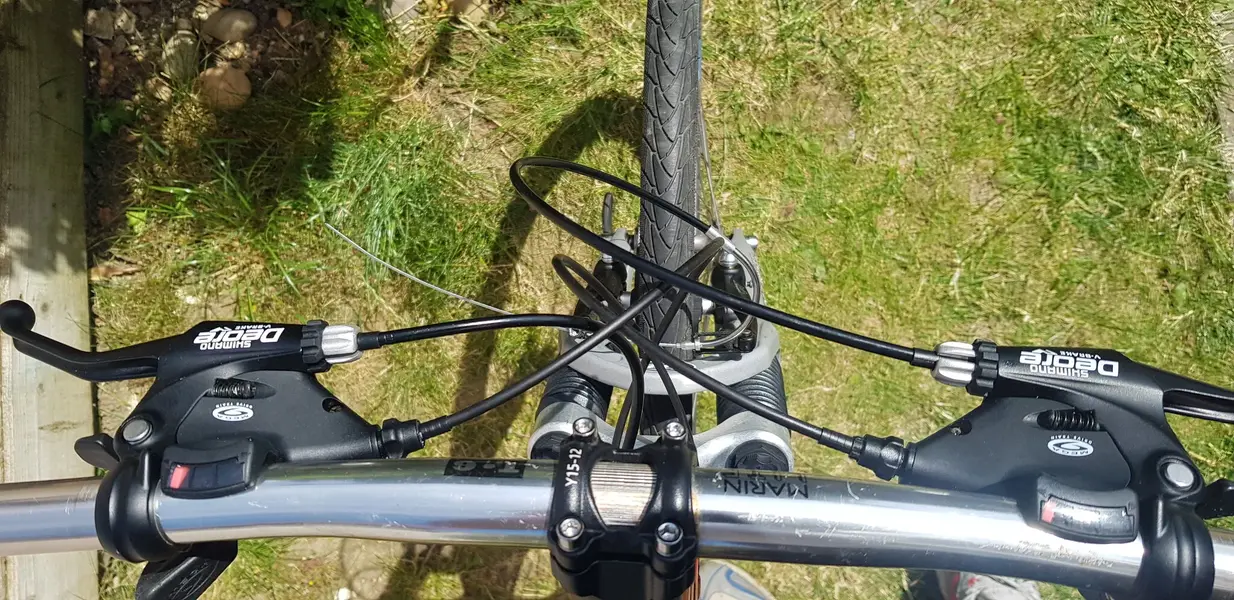

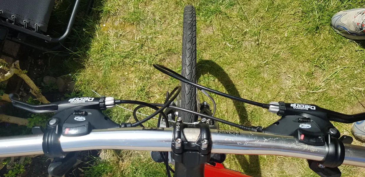

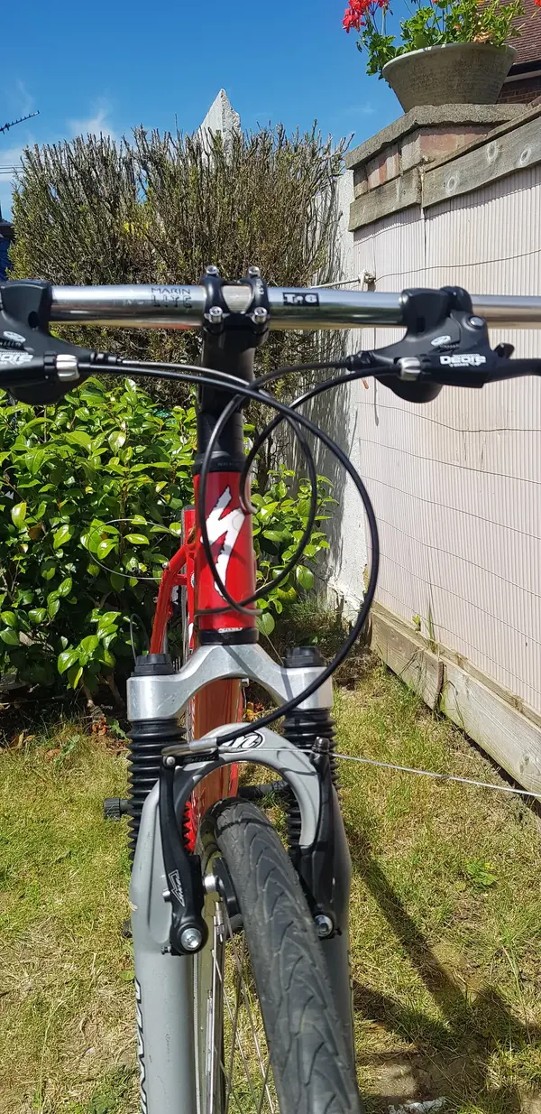

Ok, I had an hour yesterday and fitted the cables.
I think I've gone a bit long, but please let me know what you think, especially if I need to change the way the cables cross each other at the front.
Thanks
