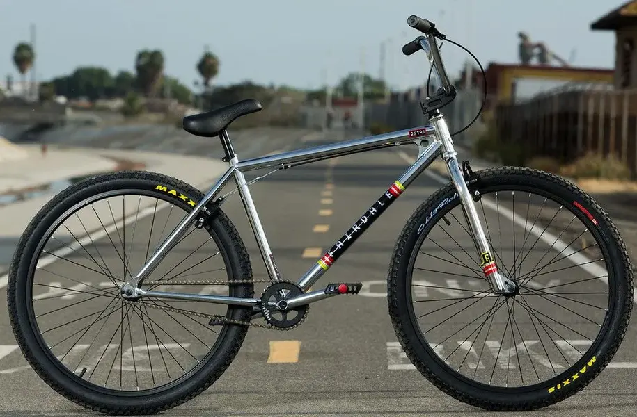

I have and old steel frame that I want to convert to a cruiser 26" Wheel BMX (type) using low rise BMX bars and stem and a single speed chainset.
What gear ratio should in be looking at for a relaxed ride? I live in Glasgow which is a wee bit hilly.

PS. Something like the attached pic.
