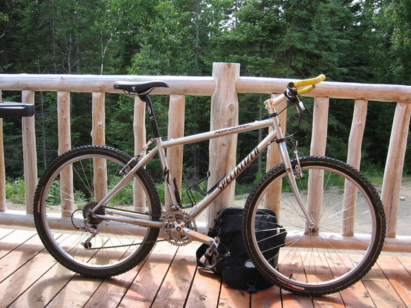

... and here's my '98 Rockhopper with a Kona fork getting converted for touring (excuse the picture quality):

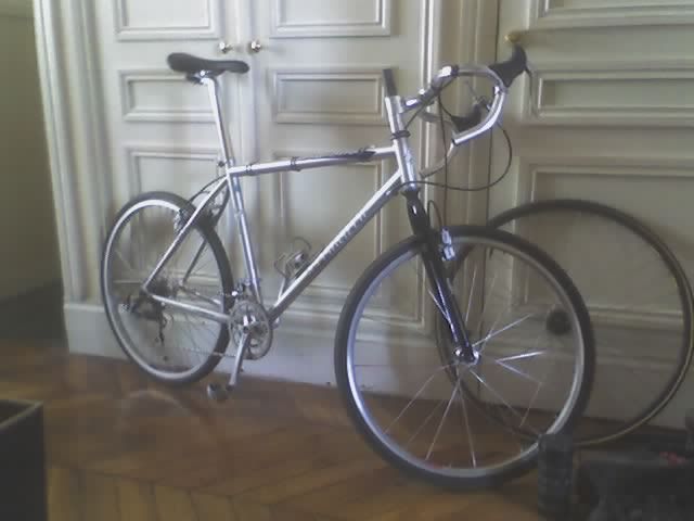

My ride will be this late 80's Torelli, minus the Flex stem and Spec saddle. Bike has the relaxed geometry for stable handling, relatively short top tube for comfort, and multiple eyelets for racks front and rear.
Frame is tigged from Tange Infinity and quite stout but still smooth with the thin seat stays.
I will start a build page when I get started on the rebuild.

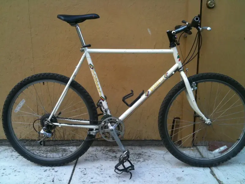

your very welcome to this 1989 offroad master frame made from tange infinity and with the required luggage racks bosses, yours for postage.
It makes me feel guilty everytime i walk in the garage :cry: :cry:
