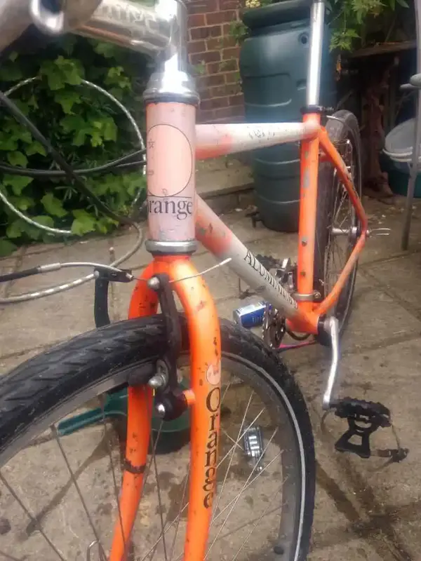

You have V-Brakes fitted (hence no point buying any).
It would have had cantilevers, something like BR-M650 and about a tenner/15 quid second hand.

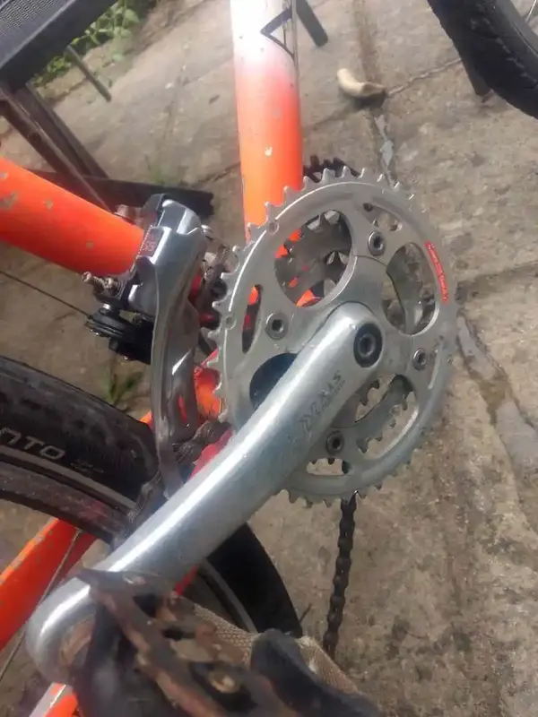

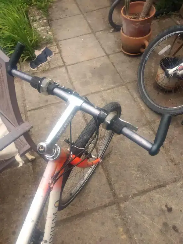

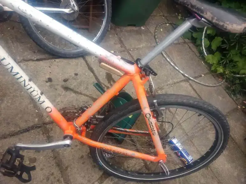

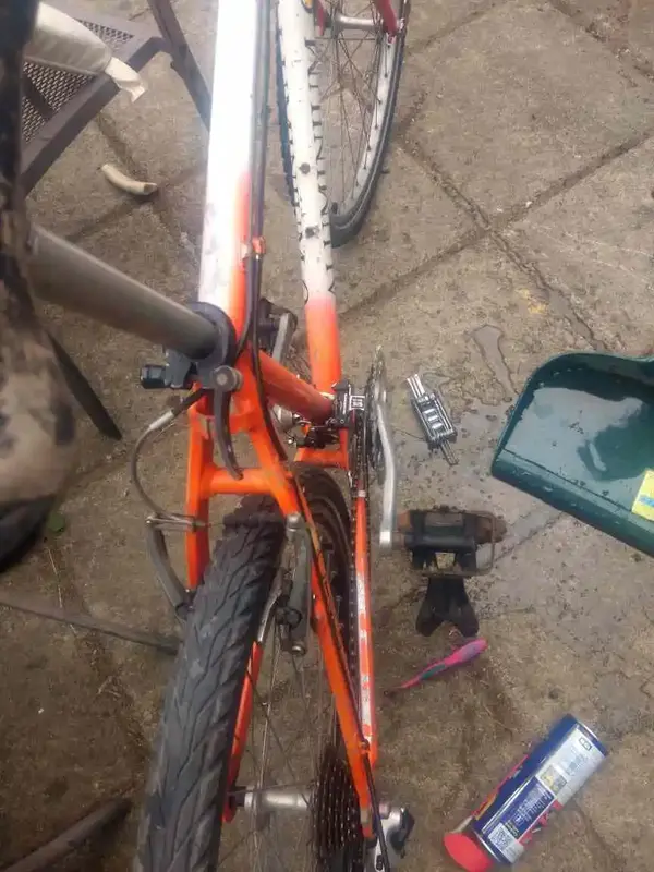

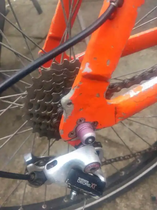

I'm pretty crap at doing this stuff tbh. My main need is to replace the grip shifters as they actually are broken. Split plastic falling off. What should I get? The brakes were probably the ones with the single Central wire that sat in the small lug on the frame. I'm confused is this v brakes?
