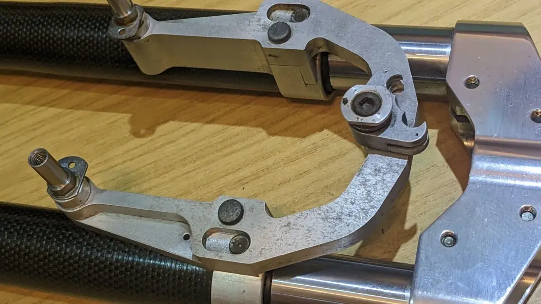

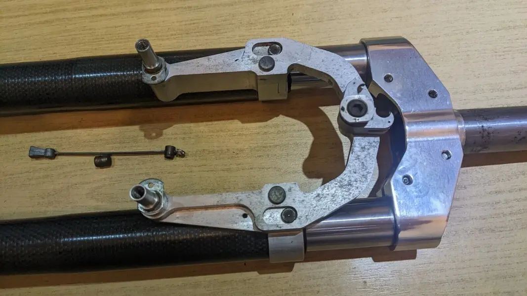

Thanks @Mace4130. As outlined by @kingoffootball, these are indeed the K and AB. I'm presently servicing an AB and comparing with the pictures stolen from this XCS, the differences are now obvious to me.

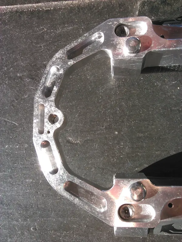

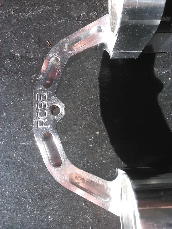

First, the brace of the AB is machined and milled (front and back), whereas the XCS one is simply machined.
Second the AB brace is engraved RC35, whereas the XCS one is... well... XCS :D

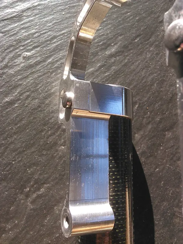

Last, the brace cast is different between the AB and XCS, where it joins the legs.
No idea if these are the only differences and if the stickers are the same.
