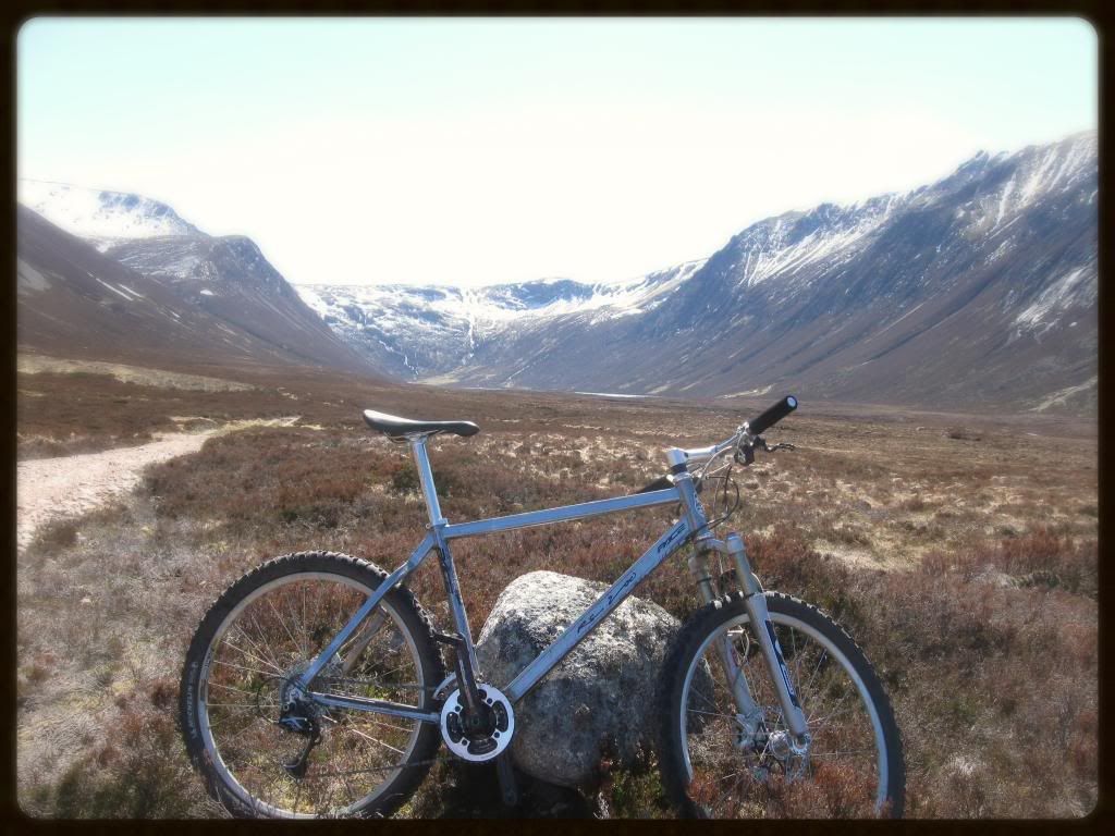

Shazam!! weighed it and it comes in at 22.5lbs :shock: , I have some lighter tyres on the way which will probably drop near a pound off that weight as well :D
Other updates:
- Superstar disc pads, cheap and work very well!
- FSA Afterburner 2-ring chainset, silver, shiny, and I've really no need for a granny ring tbh.
- Pace RC31 forks, light, responsive, made to go with a Pace frame :D
I'm very happy with the bike at present, think I'll sell the Fox forks I used previousy and look for some Pace suspension forks instead, other than that this bike is ready to ride for many years to come :D
Holy weight loss Batman!! :shock:
Fitted some Kenda Klimax Lite 345g tyres, and the weight has dropped by..... a whole pound!
So now at 21.5lbs :D
The tyres are for summer/dry use only really, there's not enough tread to grip in any kind of mud.
Pretty happy with the way it is now, hard to see how I can shave much more weight off it without spending megabucks or sacrificing reliability.
WIll get some pics this weekend :)
