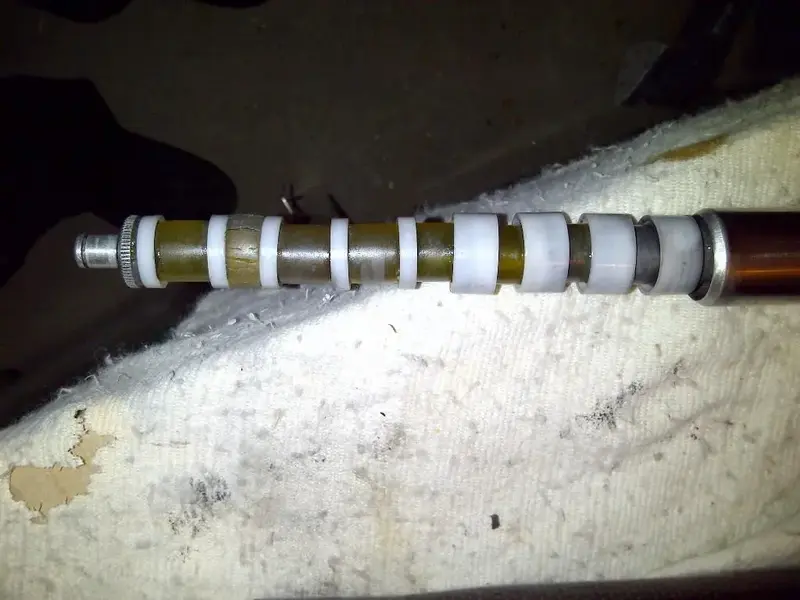

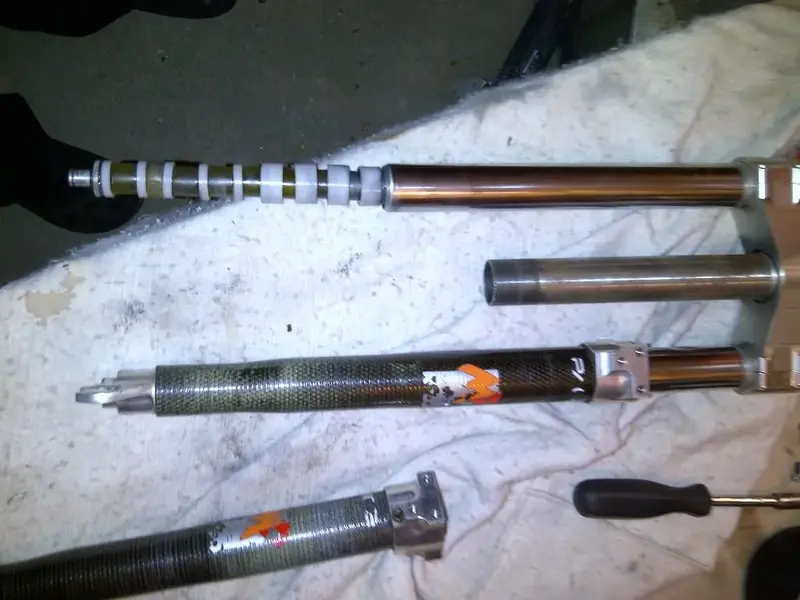

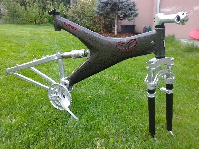

does enybody know what type of my lovely RC 35 it is? Any suggestions where to buy elastomer kits?

They are MXCD's. You can get elastomers from pace or do a kronos judy spring conversion as I did.
Thanx, is it both MXCD's? I stripped of one fork only. Kronos judy spring conversion sounds good to me, how is your experiance wit it, I´m affraid that springs can scraping and rubing on the inside of the staunchions and demage carbonfiber legs.
Got the springs off Ebay and they are no wider than the elastomers...been running it for 6 months with no problems...I haven't serviced the fork yet so haven't seen if any damage to the insides but it sound smooth in operation with no scraping noises.
Some of the mx range forks have damping cartridge so if you have one of these (or fitted the after market kit), all should be well.
