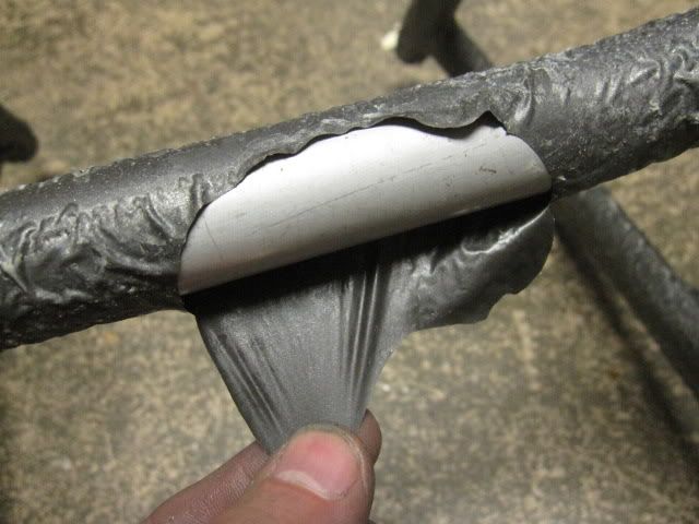

paint stripping a frame or parts just got harder
I've had some powdercoat blasted in the past, but if it's more on the 'plasticky' side rather than 'chippy' you can end up with some nasty rippling on the bare metal as the blasting medium builds up on the face of the paint. We've sometimes burnt it off a little to make it more chippy. Plastic medium is better than glass or sand, but it will all cut into the metal eventually.
I'll be trying soda blasting on my next clean-up. It's bi-carbonate of soda crystals, apparently. Sausage fingers had his Kona Easton Elite done back in April:
Thread here:
http://www.retrobike.co.uk/forum/viewtopic.php?t=143955
Not sure what it cost, but that finish is brilliant.
Also try spray-on gasket remover from car shops. It's not specifically for paint stripping, so it might get under the radar...
I've used Wurth Sealant Remover (Art. 0893 100 0) it's German, so pretty solidly EU controlled, not some of that US stuff that they can't export from California :shock:
All the best,

I have seen cars done in soda - very impressive 8)
The finish is rubish though i.e. exactly as it was before they painted it - sanding marks etc :lol: it doesnt alter it in anyway, not even the 'soft' lead filler they use 8)
WD :D
