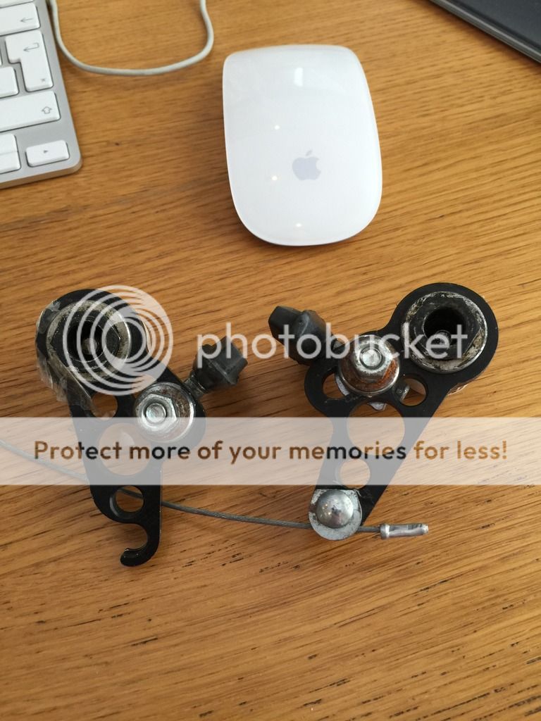

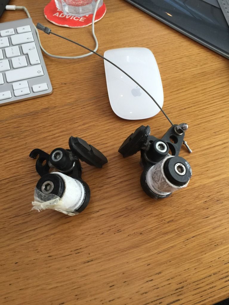

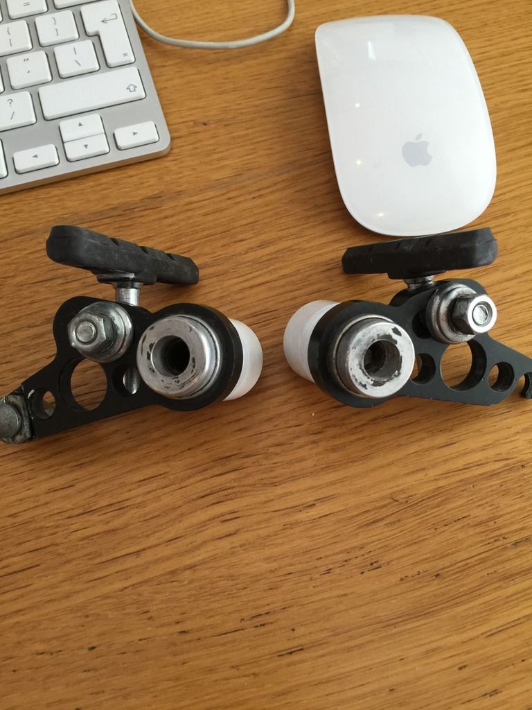

Picking up on ishaw's thread and calling all Pederson experts. Is there a way of telling front from rear on this model, because if there is I can't see it. I'm installing these on RC35s at the front so effectively need two rears, or is it just to do with the installation?
The first pair...
The second pair...
Or will I have to take them apart to look at the insides?
I believe you have to take them apart to see which way the 'thread' goes. If you take apart the spare set you have you'll see what I mean.
Not sure about the complete ones but one of the black ones pulls apart as it's not complete. Hopefully a simple task. You'd think it would say on the outside to make life easier
