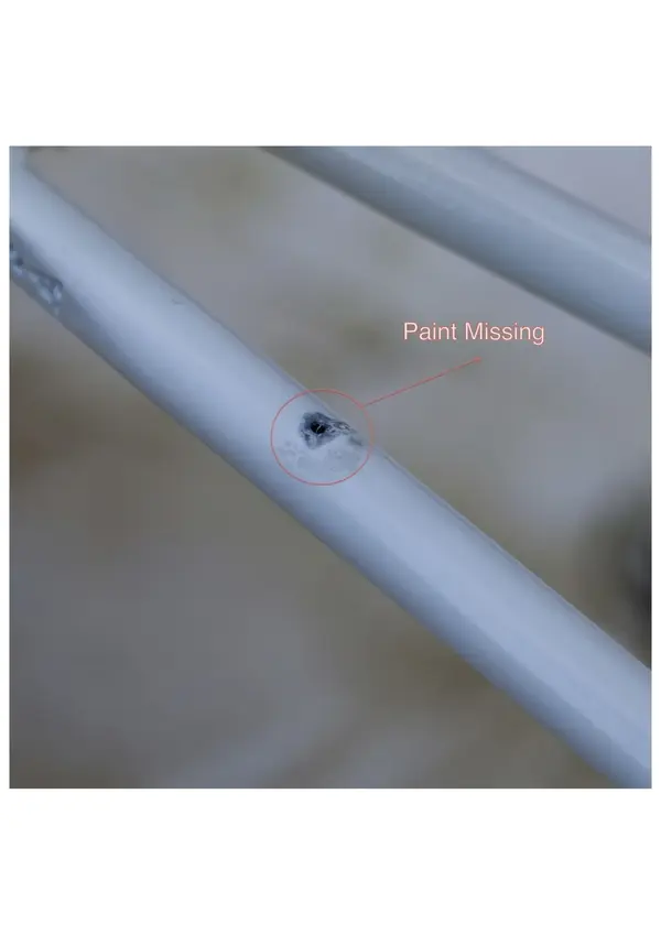

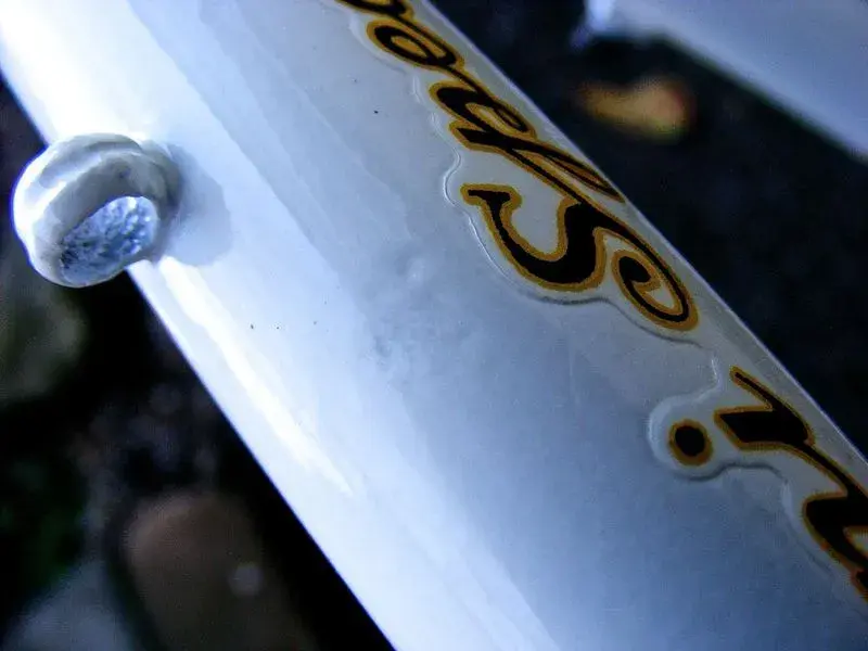

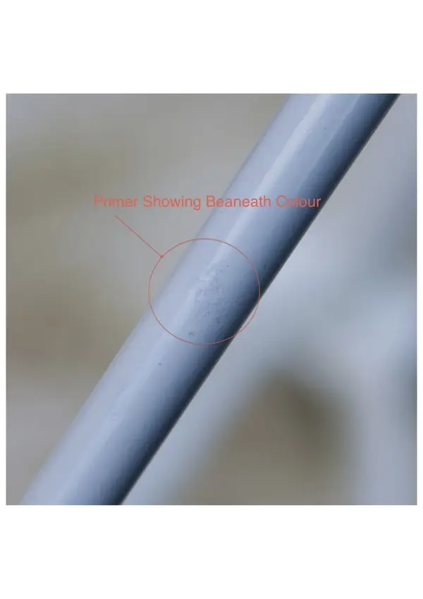

Some defects like lack of clear coat / orange peel are hard to photo, but here are 3 flaws of many which the restorer said 'he couldn't see' from the photos: He also insists the flaws are a result of corrosion in the frame...
"I am afraid the only faults I can see are due to pitting from
corrosion which cannot be remedied."
there were some paint chips and surface corrosion on the chrome. The frame , he stated, was grit blasted, primed, 2 coats, colour 2 coats, lacquer 2 coats...so why does it look like a rattle can job?
Paint missing
Base coat showing through
Chips from previous paint not filled, the decals are supposed to be under 2 coats of clear coat, you could get a fingernail under the edge here...
Doesn't look good on the photo's.
How far away are they? worth a trip out so they can look at it with you and explain why it looks the way it does? Very retrained of you not to mention them I guess.

Right I've seen reactions like that and something was either not cleaned properly or the powder coat or paint got contaminated by thinners or a pre coat that was not wiped off or was too wet before the finish went on.
That is not delivery damage that's a paint reaction which in theory you have them bang to rights and as suggested by Midlife you need to show up and ask them what would cause a reaction like that?
I'm sure there are actual paint guys on here that can give you a firm more technical answer on the reaction!
