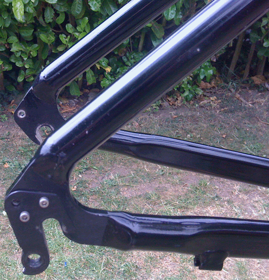

If your dropouts are like this:

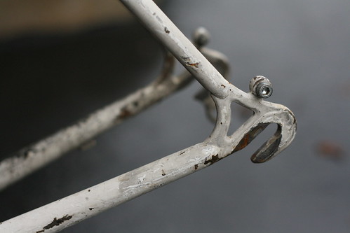

I probably wouldn't bother because it makes things much more expensive/difficult. What you want are dropouts like these:
With the latter you can adjust chain tension by moving the wheel backward.

Drop outs are like the former not the latter. Is that why I've seen pickle's Karakoram with a chain tensioner to make things easier?
Hmmmmm :shock:
pickle's karakoram is single speed with a freewheel, not a fixed gear.
you can use a tensioner on a singlespeed but not fixed
