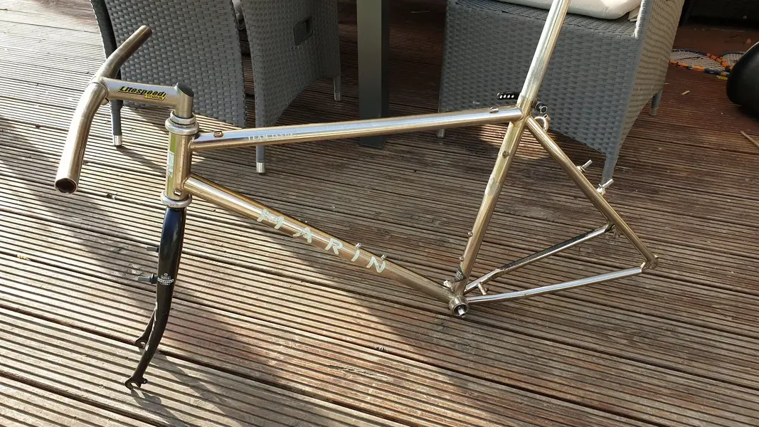

Would LOVE to know more about and the differences between the 92 Team and Team Issue...
Mostly because this just got posted from Germany, and I've got a lot of waiting to do before I get my hands on it:
(Not correct or original decals, of course. Although I personally quite like the white the previous owner went with and I might even replicate a set in that colour as an option when I get new ones made)

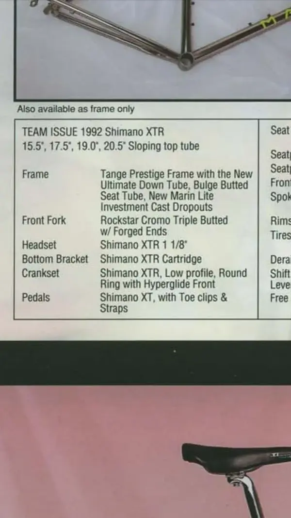

I will get on the case. We really need owners/previous owners to give us a definitive comparison and pictures.
Then we can build a quick reference guide n all.

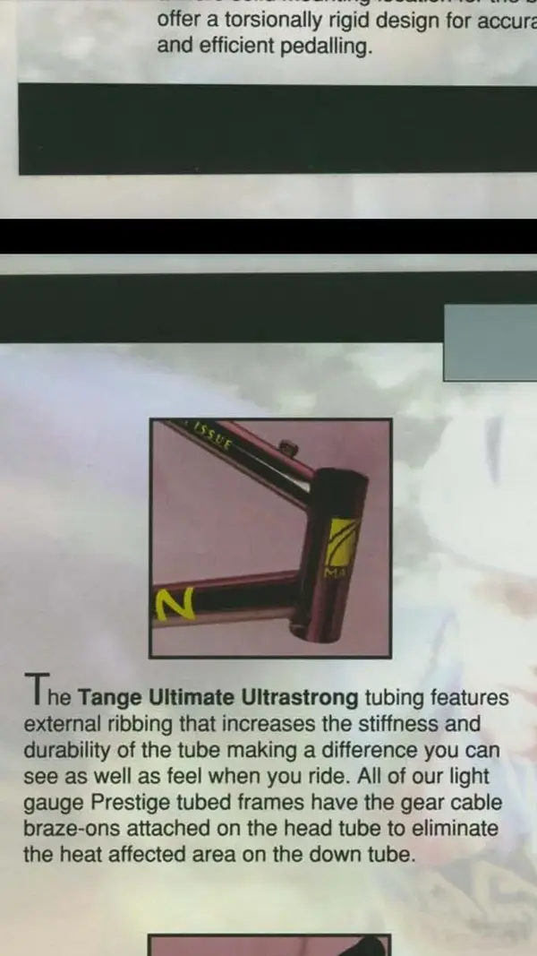

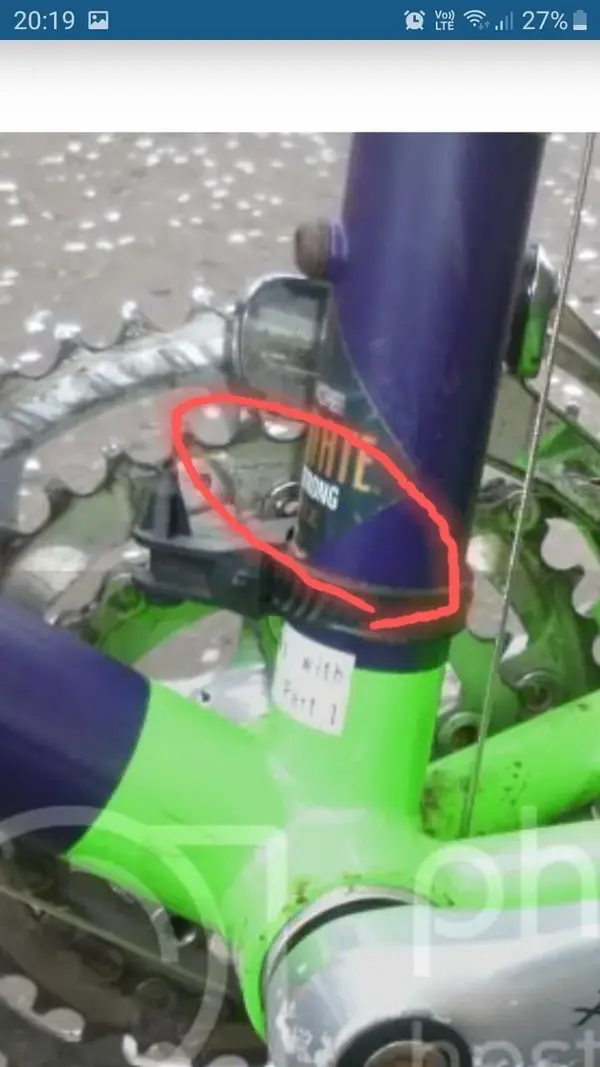

Ok, seems not, if any difference between issue and team for 1992. Tubing wise. I'm certain geometry is different though and maybe...yeah pedantic...the seattube decal on issue actually says 'ultra strong' where team....not sure.

Yep team also has ultra strong decal. So, they appear to be the same. Team + issue for 92.
Unless there is real subtle stuff like panniers eyelets. Aha, that's now solved with an edit...both have rack mounts.
For that year anyhow.
