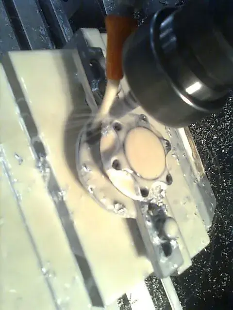

Been a busy boy this week,
Got the other track end done and brazed on, don't be afraid of the rattle can spray, its just to stop it rusting while I plow onto stage two.....
A suggestion, if I may :roll: ?
A 4mm rad. on all the rear facing corners of the track ends would make it all look smoother, in my opinion.
Disc brake mount in progress
Here is a teaser
More photos to come when its assembled with axle

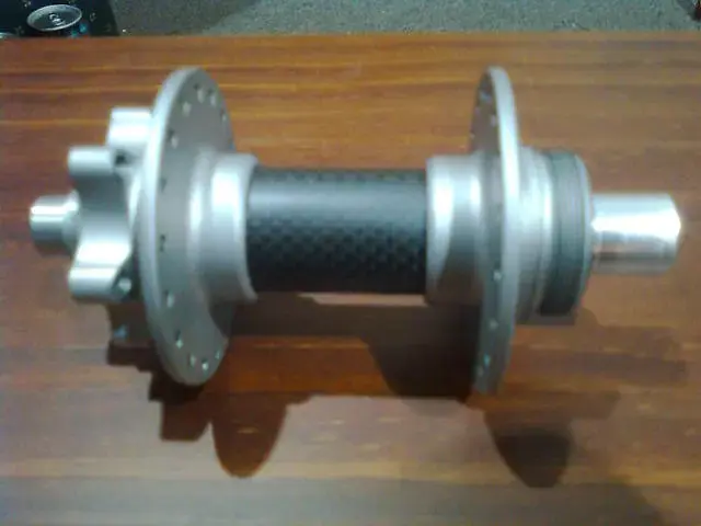

Not a lot to say,
Its a hub, its made from a few that I modified and an old seatpost :wink:
Installed sealed bearings as I suck at maintenance, I prefer to ride!
weight: 220g
Finish is glass aggregate shot, I thought about polishing it but honestly it seemed like to much work
