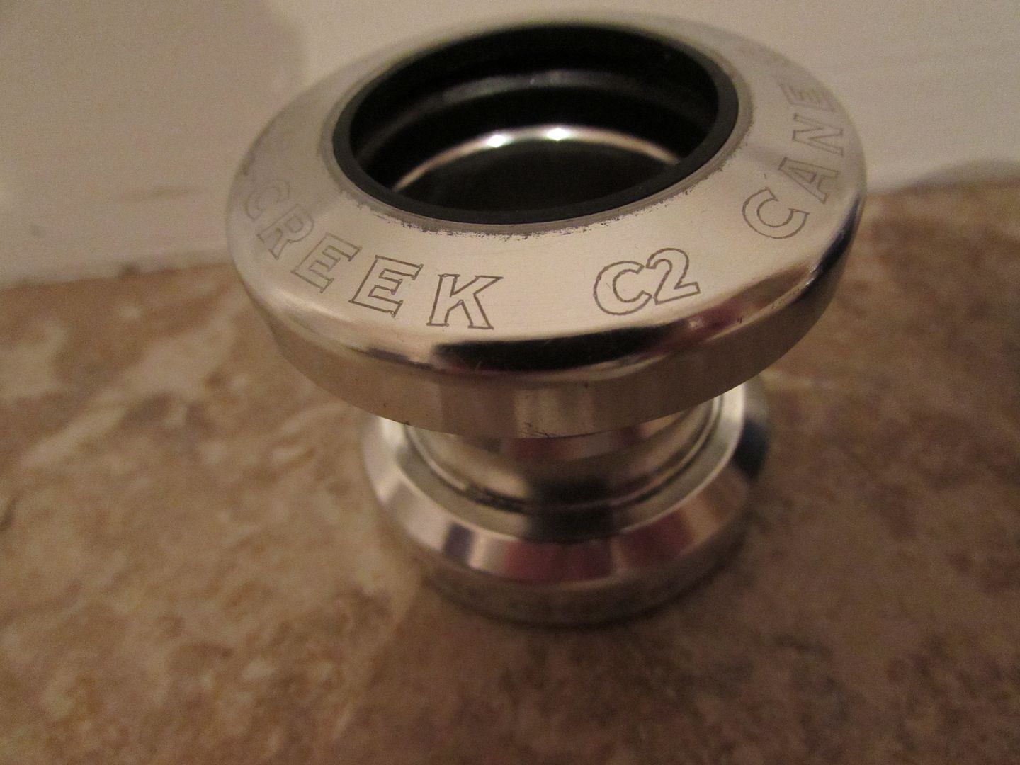

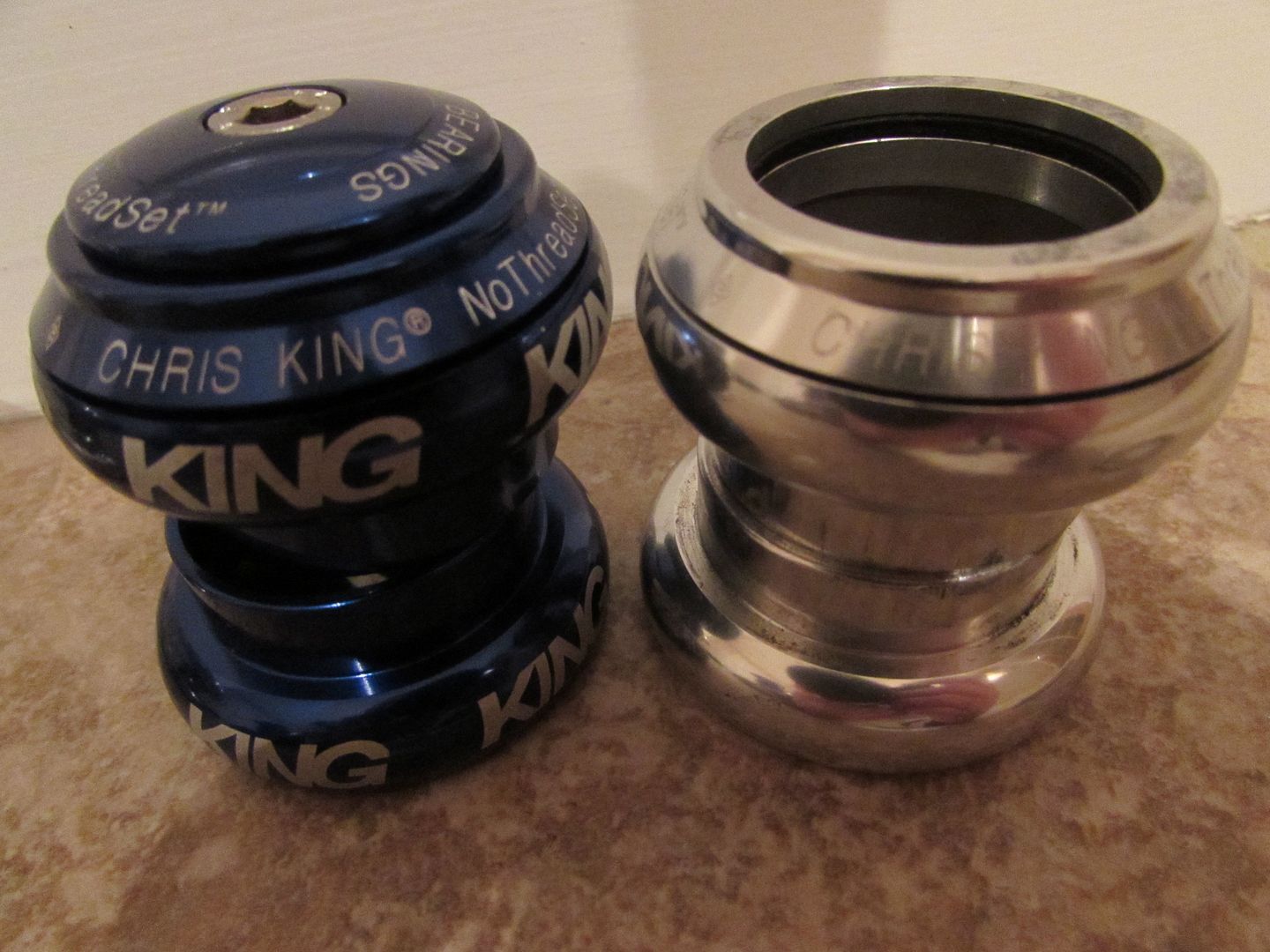

Had the day off work today, owing to my lack of tools I ran the frame to my LBT to have a headset fitted
Big decision before I went was which headset to use, original build was to get as close to the catalogue spec as possible, but that disciplined went out the window sometime ago :D
Option one
Silver Cane Creek,
Option Two
Blue Chris King
Option three
Silver Chris King
The C2 Cane Creek is the ugly duckling of the three and doesn’t compare to the Kings
The Blue King turned out to be the wrong shade (too dark) Blue so the Silver no Logo sort of selected its self, since I’m planning to use a Syncros stem the missing top cap isn’t an issue
Going back tomorrow to pick it..

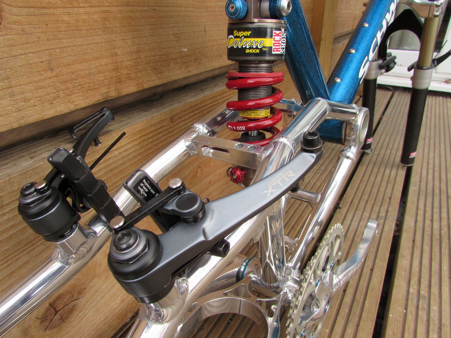

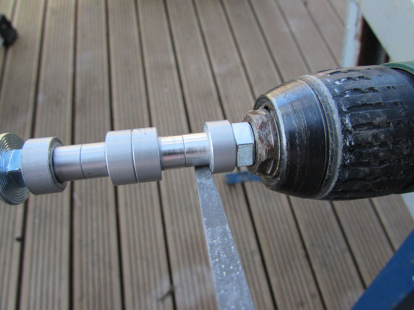

Having stripped the rear end down so I could polish the U.R.T I was staggered to find that the Alloy shock bushings were so dam tight in the eye’s of the R.S Super D they appeared to be seized solid, upon inspection the O.D of the bushing was bizarrely just to big, how the shock/rear end managed to pivot I’ll never know
After looking for someone who could reduce the OD of some Shock bushes by (I’m guessing here) a few thousands of an inch I thought I’d have a go, if it all went horribly wrong I just have to buy new news
So using a bolt I managed to mount them in the chuck of my drill and taking a Needle File I very gently removed the anodizing allowing the shiny alloy to appear, and after many test fittings and shaving small amounts off I was happy, a quick polish with a thin strip of 1200 Silicon carbide paper I was happy
a quick polish with a thin strip of 1200 Silicon carbide paper and I was happy :D
not sure how good the fit should be, but they now fit snug enough to stay put even when turned upside down, but give the shock a very gentle tap and they fall out,
Cheer Narder ^^^^

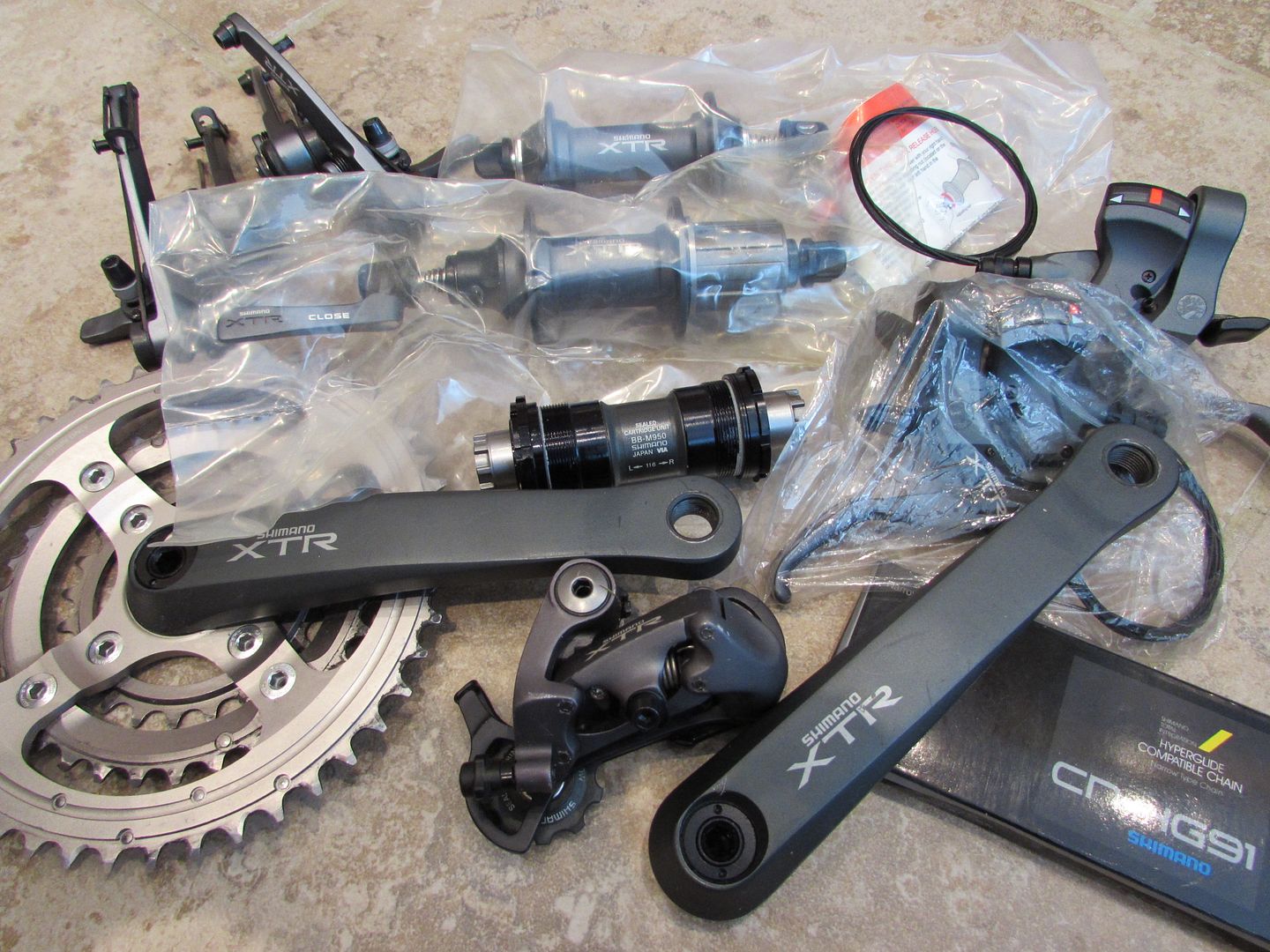

Got the frame back this morning and finally started to get the assembly stage underway
Rounded up the parts I’d been hoarding, mostly m950/951 a lot are NOS and others very low mileage, however some of the hoard like the cranks and bottom bracket have now been superseded
Not sure where this build is going to end up so I’ve been rooting out all the Blue anno spare parts I’ve squirreled away over the years, The blue Answer bars and Hyperends ?
After an hour of fettling it’s once again starting to resemble a Bike, Not sure on the zero rise stem as the overall bar height is about an inch lower than I’d like, and I'm not a fan of using tons of spacers that end up spoiling the aesthetics ....but I've not summed up the balls to chop the steerer down just encase I have a change of heart :?
