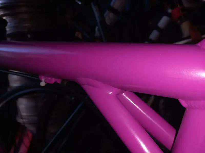

Hard to get good pictures of bright pink. It's a satin not a gloss but it's pretty darned clean.

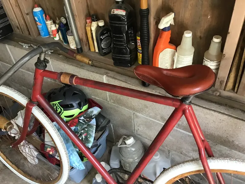

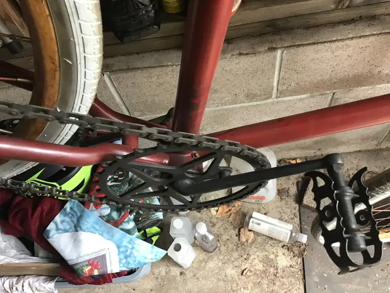

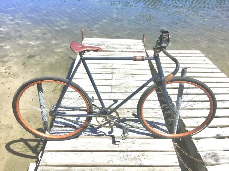

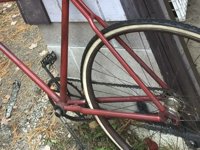

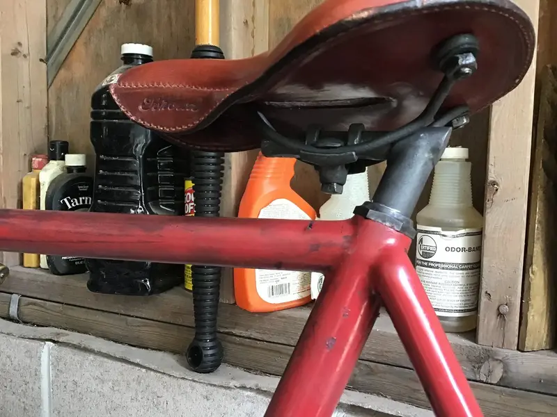

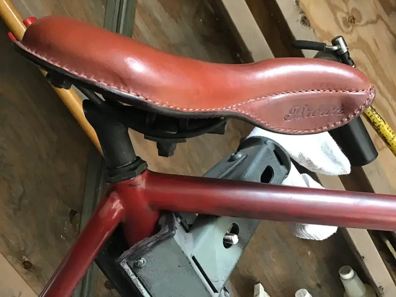

I use semi gloss on antique frames. Nothing looks worse than original cleaned up rusted parts and a pretty frame. I age the paint on these bikes by rubbing in stove black and graphite spray lubricant in places that usually look the worse on an old frame. The parts that no longer have any nickel plating have stove polish on them. There is a ton of prep here to make it look factory. I’m not concerned with the brittle rattle can paint chipping off or scratching as it adds to the authentic looking finish. I used my home built spray booth for these frames. 32BE6B88-BE9F-4C71-9F0C-B86646DE3C6A.jpeg 1295BD70-48DE-4436-B079-8100409BC8FF.jpeg 2841FBC7-1060-4F8F-89C7-486041F151DF.jpeg C9C2034F-8611-47BC-B90D-7AE83BC72250.jpeg 142178C3-1B74-4DD3-8793-C250998C3813.jpeg BC3DDFFC-EA53-49F2-A7A2-14ACF3C65D2C.jpeg E7AD67CB-2D8F-4DBA-AFD1-50A8317FE7E7.jpeg 5B114AB3-B725-4FF1-BB47-3C36A1C96EA6.jpeg
