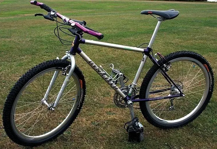

Apologies, bojangle, for obscuring the sticker with the chainset in the first pic, here is a 'nearside' shot of the machine clearly showing the XMT100 Metal Composite frame tubes sticker. Cheers

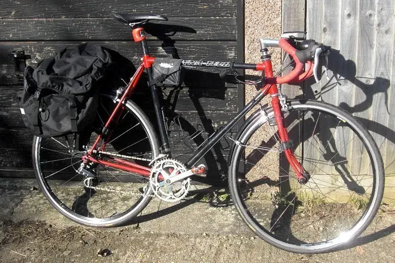

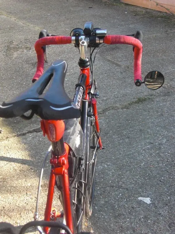

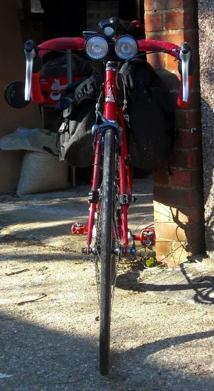

Here's my Dynatech - it's a road model, the 300 and it's my daily commuting bike. I decided to stop driving to work back in November and now do 30 miles a day by bike.
It's a 2050 frame (Renolds 501 equivalent) with a bizarre component mixture of Sora, Exage, Ultegra and Dura-Ace. Wheel are FSA, carbon seatpost for comfort, Selle Italie Fliante for a similar reason. Lights are to see my way home on a particularly pitch black cycle path and the rack is a 'layback' style to stop me belting the panniers with my heels every revolution.
M-Trax and Dynatech were available at the same time - M-Trax being sold in the 'normal' dealers and Dynatech in the 5* dealers only. My main MTB is an M-Trax Ti-1000 frame built up with modern components.
