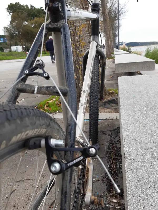

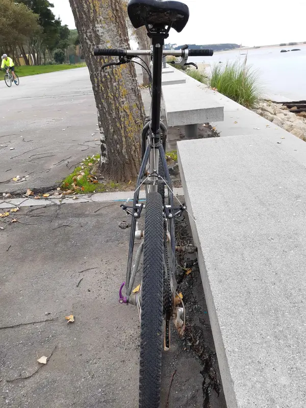

After months of putting it off because cantis are usually a pain to set up, I finally got round to fitting my Tektro CX brakes on the rear of my MT4. Surprisingly easy to install and set up, I got everything positioned just right on the first try. That's a first for me!
And I'm impressed, amazing stopping power when coupled with a DiaCompe SS5 lever. I may get another set to go on the front.
I actually wish I'd known how well high-profile CX and touring cantilevers work way back in the 90s when weak low profile brakes were what the bike industry wanted to sell us.
