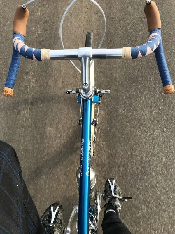

So I starting accidently taking over Jamiedyer's Mercian KoM thread discussing this. Thought this needed its own thread. As mentioned elsewhere and the Road Wanted forum, I'm looking into to getting a fast touring frame. Since it'll probably encounter some rough stuff, I'm looking into something that can handle miles on the road but also deal with gravel. Obviously there's the Nitto B135 and B136 (as reading Jamie's views I'm probably leaning to towards the 136's). The 177 Noodle also interest me, since I think I'd still prefer a bit more drop than the B135/6 would offer, but if I'm right they flare a lot less.
I'd be looking for something that would fit a 25.4 quill stem, but I would probably consider a 26 (since that's what the 177 seem to be). I also usually ride 42, but I'm thinking of going wider

I think those are too wide for me and definately too shallow. But I supose they come into their own on a frame like the 'trucker, just as much as they would on more gravel specific bikes?
Thought I'd include some pictures of what I'm considering
Nitto 177, which have a 140mm drop, backwards sweep and slight flare. But aren't proper Randonneur style bars.

Nitto 136
Velo Orange Grand Cru

I had simmillar deliberations for my tourer: in the end I went for Dirt Drops which I'd used off road before. Getting them high enough means that the drops get used, and they're all-day comfortable. The flare is everything.
