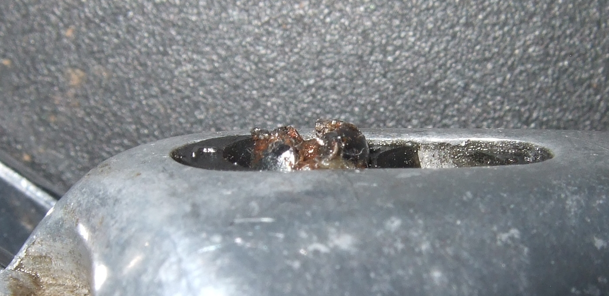

Hi Folks,
2 images attached.
I have a used Deore DX M560 Rear Derailleur with a Stroke Adjusting Screw that I haven't been able to unscrew any further because the head has become damaged due to the torque required to turn the screw. I am guessing that the screw and/or housing has some kind of corrosion that is making it difficult to turn.
I was lucky, I guess, that I was able to unscrew it enough to check the overall functionality on a bike with a 9-speed cassette.
I have managed to extract the Upper (small sprocket) screw but it was difficult too but I was able to fully grip the head with some pliers in order to do so.
With the Lower screw there is not enough head protruding in order to get sufficient grip. The edges of the heads are spherical (curve inwards towards the top of the head).
I did spray some WD-40 in there but still no go.
In order to not damage the body of the derailleur, what tools and techniques can I use to extract the screw?
When I get new screws, will Park Tool Anti-Seize Compound0 (ASC-1) be appropriate to prevent such problems in the future?
Thanks!!
