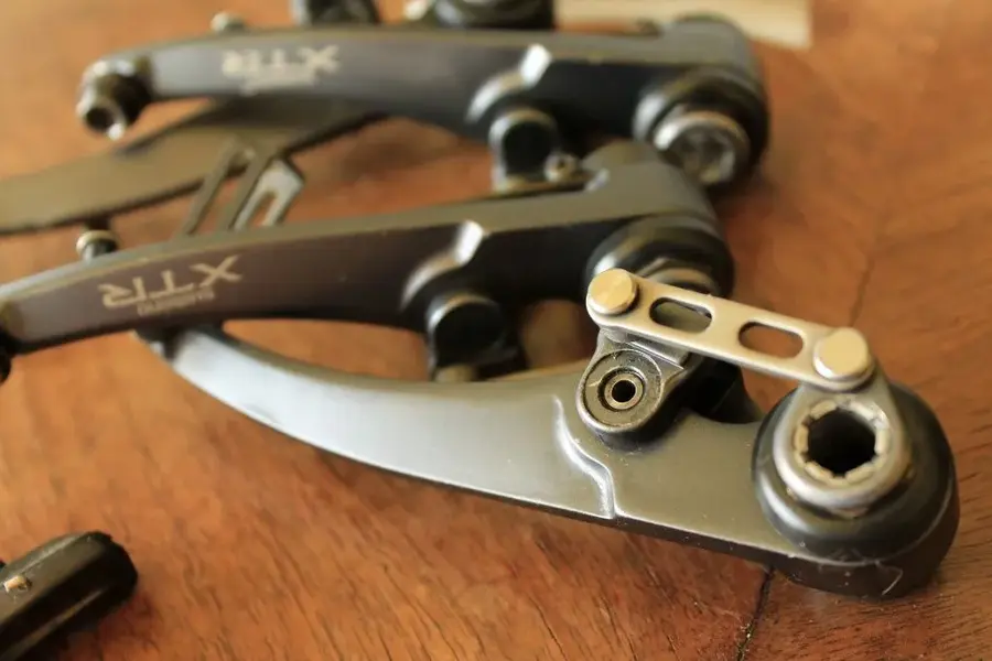

I've got a pair of M950 parallel brakes, but one piece of them is so dirty inside. Means, I clean them, but it does not move smoothly. If I fix them to the bike, they are perfect, but if I move them with my hand, then I can feel the problem.
I spray a lot WD-40 on it, move them continuously 15mins, and a lot oily sand comes out from them.
So, I think, it should be a better solution to take apart them, and clean them seriously.
How an I take apart them? :)
Or have somebody an illustration from them?
Thanks!
Undo the grub screw behind the brake bad holder and tap the pin out.
Then using 17mm cone spanner undo the nut at the end. 6 or 8mm Allen key (i foirget) in the back to keep it still .
Clean up the bearing / buy new parts as needed.
Stock it all back together a bit like doing cup/cone hubs.

Any idea to clean, repair the BR-M739? It hasn't got the rubber cover, I have no idea to clean or take apart it...
