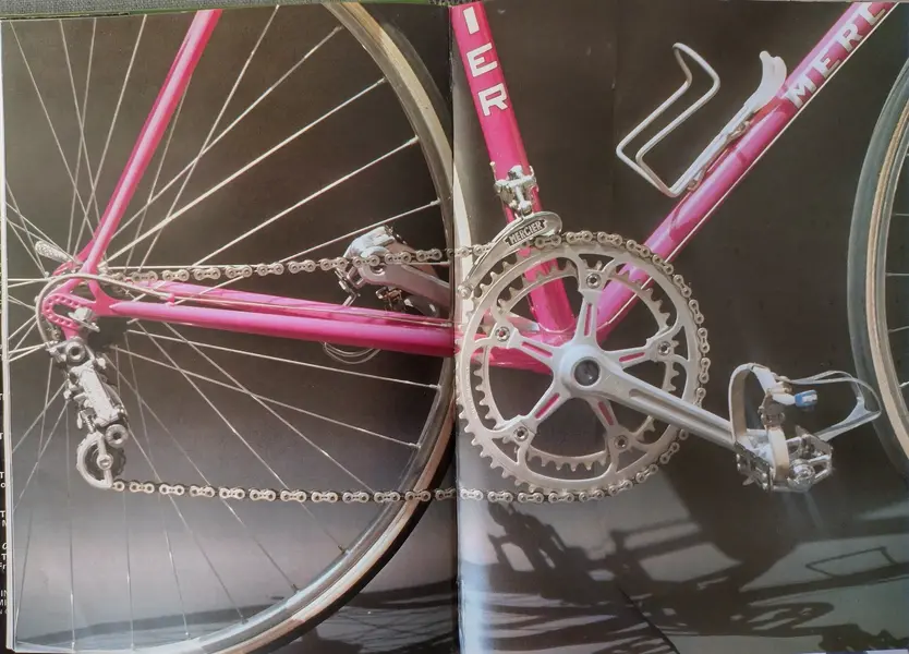

		There's an idea! Imagine a nice close ratio double chainset and a proper 4 speed block...what a combo!

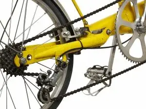

How about finding something from the tip that is made with a pressed steel horizontal drop-out - BSO / cheap bike or even a kids bike. Cut the drop-out with the hanger, file it all square, drill and tap the steel drop-out, bolts on the inside of the two-bolt Simple drop-out. It could look a tidy job.
I do like how they picked out their accurate drilling with paint. You can make a silk purse out of pigs ear...good to know!Just snowed under with work unfortunately. Got to keep the weans fed.,
Planning to run a 9x1 with 11x32 or 11x34 cassette. Shimmy rear mech.
Thanks for the suggestions - I'll stick to my current hanger, but need to decide whether to drill an extra hole in the dropout (what can possibly go wrong?) or find another way to stick it on (gaffer tape?).
One bolt might be enough - the hanger's tang goes flush against the dropout and will act as an extra point of support.
Surely, this world has seen worse crimes done to dropouts...
It might be a crime but the job was executed with skill... Not Stevie wonder with a bradawl.
