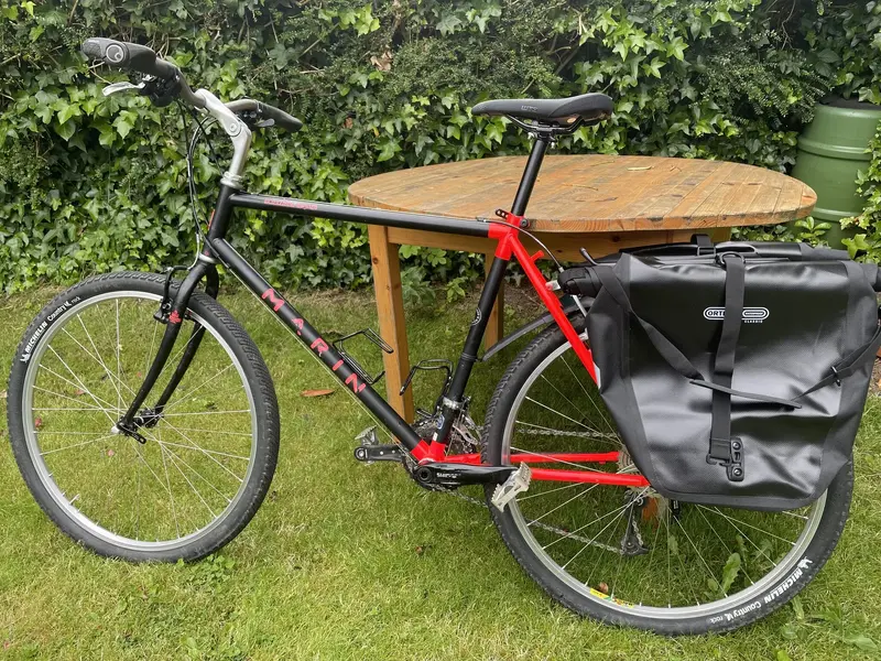

Some adaptions done, it’s not pretty! 🫣
Trying an adjustable stem that I forgot I had, riser bars , straight seat post, new saddle and rack. Now I need to get out and see if the back pain benefits outweigh the style negatives haha. Will have bar ends but I’m not putting those esi grips back on until I’m certain

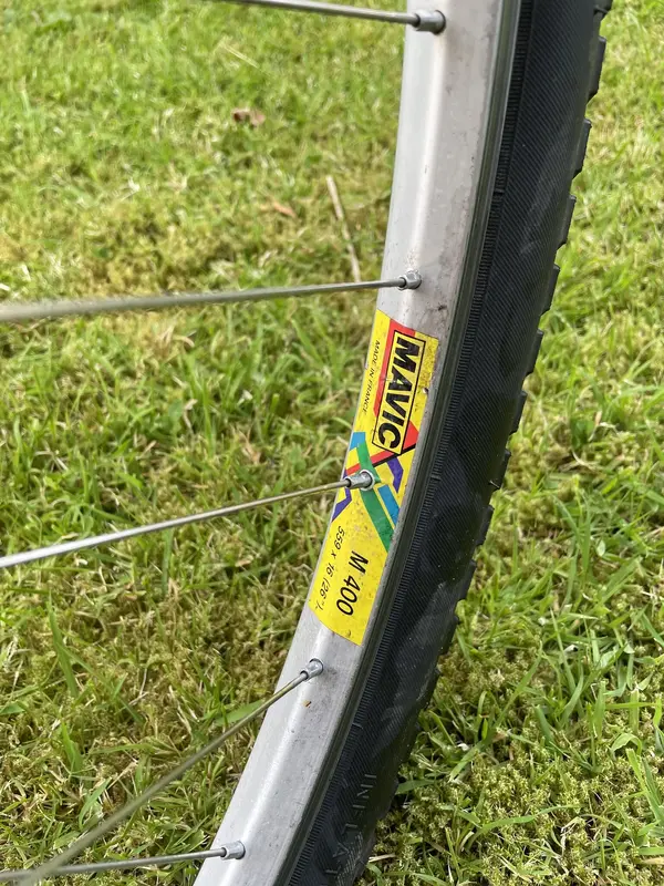

These are the wheels I’ve currently got on the bike, think they came from a 95 Marin. Assuming the rims aren’t worn (which I need to check…metal ruler on the rim surface?) do you think they are up to the job? Going to be carrying a fair bit of weight , mainly me, but also 2 panniers etc. don’t want them imploding half way!
No sign of cracking round the spoke holes, which is usually the way Mavics fail - should be fine.
I rode the US Pacific Coast with camping gear on Mavic 231s and 32H hubs. The rear gave out some years later when the sidewall cracked from wearing thin. I've run 231 ever since, although nowadays with a 36 on the rear.
Wheels should be fine, it's the spokes & tension that are most important; ie the 'build' quality.

This is how the bike is looking now , not sure about this adjustable stem, seems to be some play in it. I’ve got a quill / ahead adapter thing coming so that should give me a few more options…
