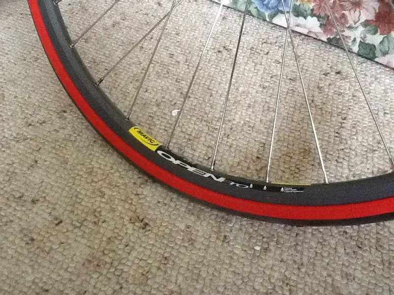

just had new rims built up gray anodized Mavic Open Pro low profile look old school.
As I know, open pros and even open sports (half the price, not too heavy, durable) even come in silver colour if one's aiming for more retro appearance. :)
As far as I'm concerned the Open pro and similar are current modern rims. They have a different shape compared with the older shallow box section rim.
