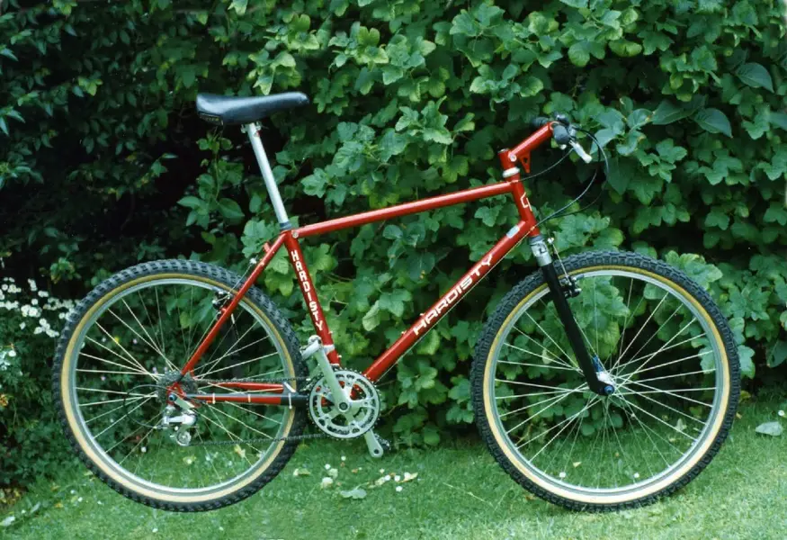

I ran short cage XT with a 12-28 cassette and MTB rings. No problems and I miss having the clearance on my modern bikes.
