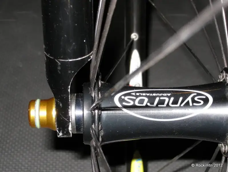

 i've checked other forks i have on hand and there's no clearance issue, ONLY with the powerlite fork :roll:RockiMtn":2v7ogx4y said:so first thing that needs to be sorted after I give the frame a good go over to clean/tidy it up is to address my front wheel and fork issue. it's been radial laced and unfortunately, the spokes have been laced outbound. because of this, there's not enough clearance between the spokes and the fork drop-outs.i've checked other forks i have on hand and there's no clearance issue, ONLY with the powerlite fork :roll:
i also have another radial laced front wheel and spokes have been laced inbound, and there's plenty of clearance. so my solution to this, have the wheel relaced with the spokes inbound.
Rob Atkin":3ewmjouf said:RockiMtn":3ewmjouf said:so first thing that needs to be sorted after I give the frame a good go over to clean/tidy it up is to address my front wheel and fork issue. it's been radial laced and unfortunately, the spokes have been laced outbound. because of this, there's not enough clearance between the spokes and the fork drop-outs.i've checked other forks i have on hand and there's no clearance issue, ONLY with the powerlite fork :roll:
I'd prefer a properly laced 2/3 cross wheel, protects the hubs, tension can be higher, stays truer longer... this isn't the sort of bike for a "racers" look IMHO.
