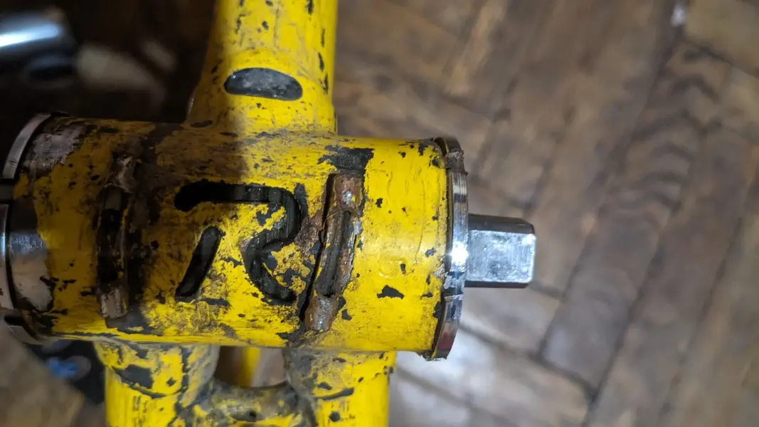

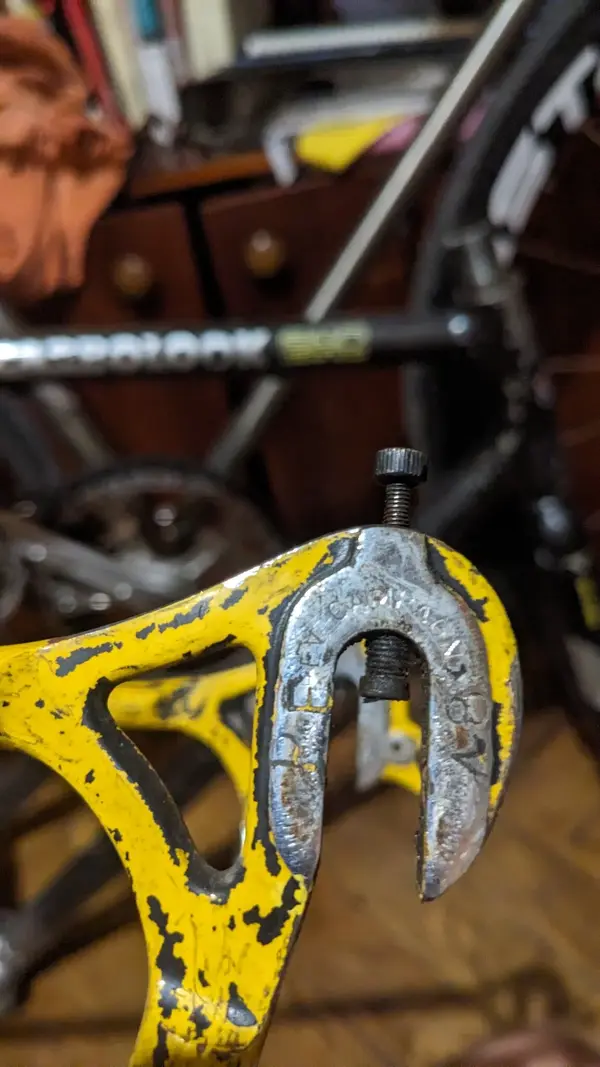

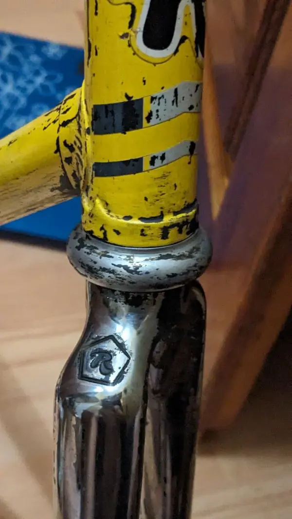

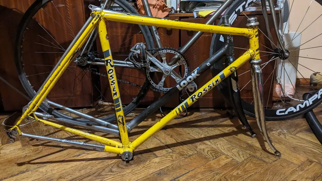

Would like to find out anything about what kind of Rossin frame I got. Seller did not provided any info about it.
Seams like seatpost diameter is 27.0 and tubing sticker is kinda still there.
Looked through all the place i could think of and was unable to find anything, apart from 54 on BB and 48 on the left drop.
I think it is probably from the late 80's or smthn. And it seems like all the stamps, typical to rossin frames, on their places.
I'd say mid-80s. The 54 on the BB is most likely the size whilst 48 is most probably the builder id which often has a couple of letters too.
Usual tubing for such a frame from that era was either SL or SLX.
There`s P and E on the upper part of the drop.
And looking on the what left of that sticker, should be SL tubing, looks similar to SL tubing stickers on same era bikes

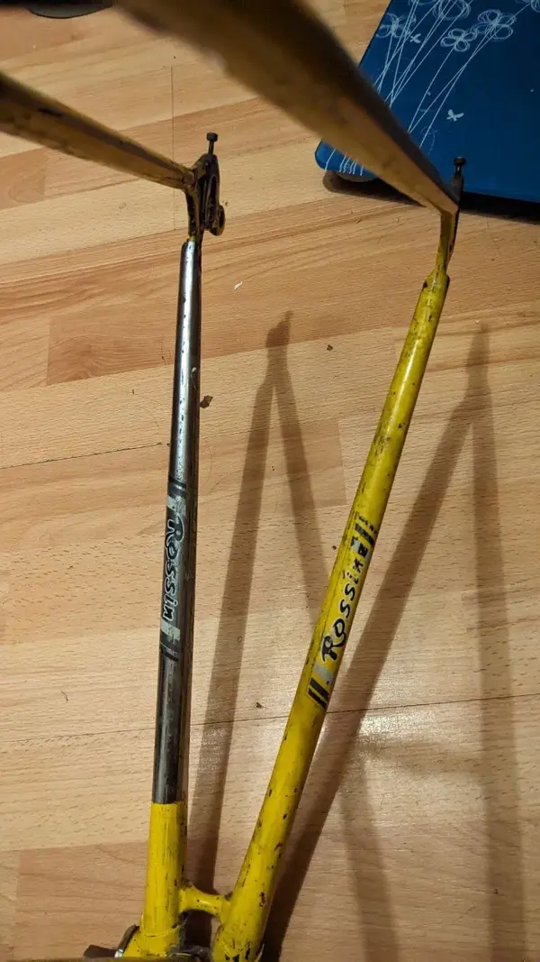

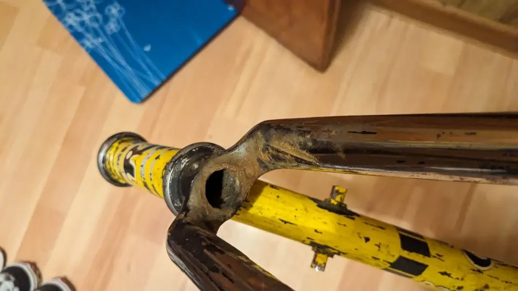

Can you post images of the chainstays and fork blades?
Not sure if I chosen right angles, by if u need different photo, gonna make it

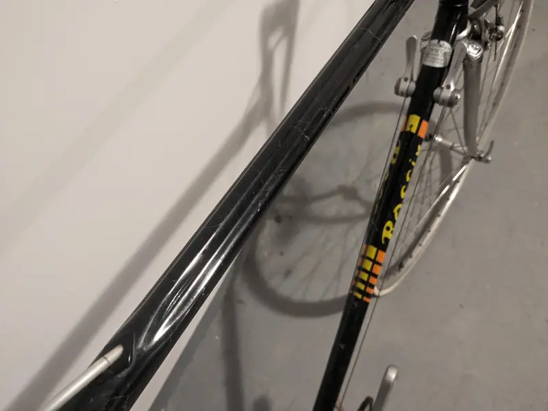

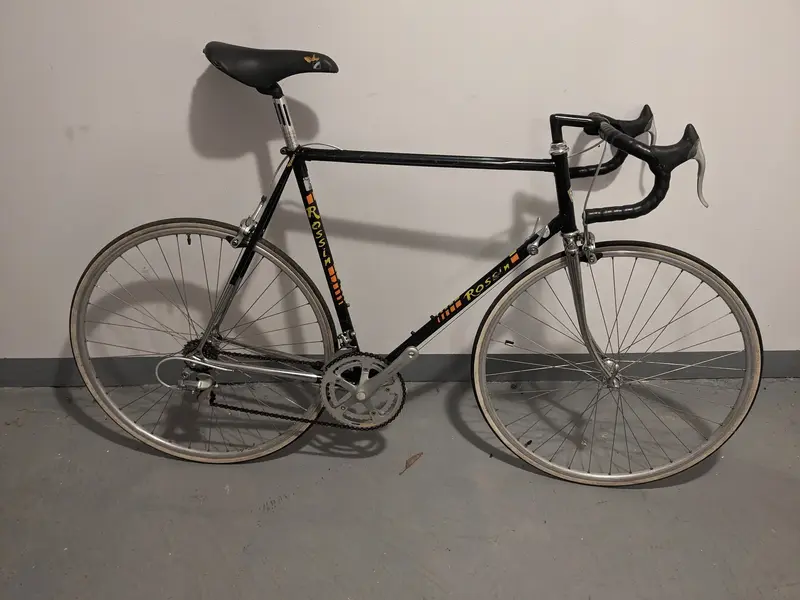

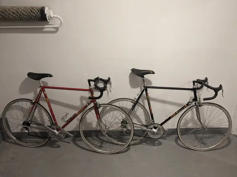

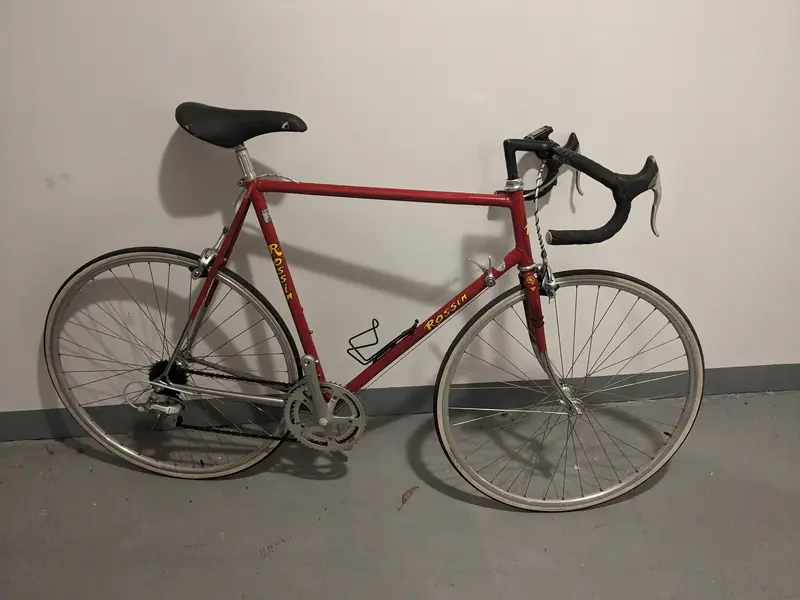

Hello, I would like to ask you for help. I recently bought two Rossin bikes and I would like to know what frame model it is? Maybe you can help. The frames are virtually identical. Regards
