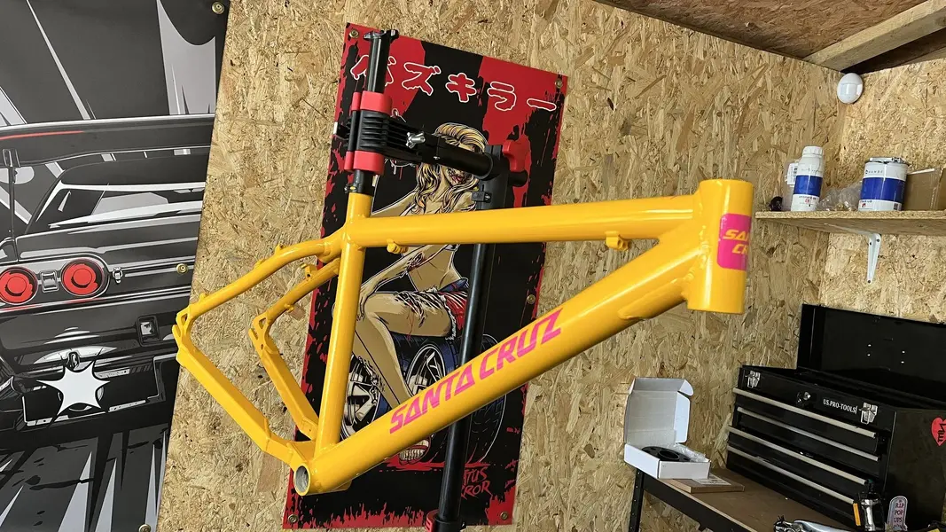

So far so good! Off to the powder coaters it went once I'd stripped all the remaining 'protective duct tape' off the frame. I decided as I wanted to build a modern spec on an older frame, it would be fun to go with a similar theme to the latest Chameleon... so here we have it in beautiful RAL 1028:
I then began re-assembly. Stupidly, might I add - because I'd forgotten all about that bottom bracket that took a LOT of work to remove. Thankfully, the threads just need a little chasing - so there'll be another short trip to a shop in the week - another tool I don't have.

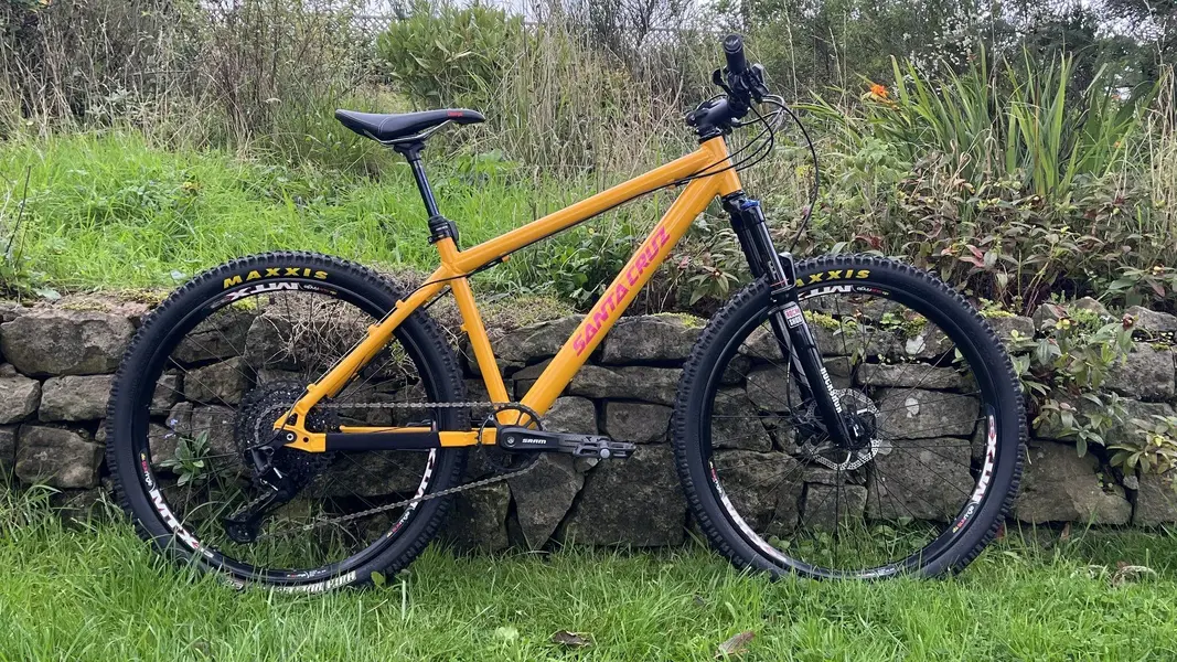

And here's how it sits today. I've swapped out the bars and stem to something a bit less awful than it had before, and to give me a little more width - as well as adding a dropper seatpost and some cable-to-hydraulic hose guides to tidy up the routing. I've since bought some bits off Marketplace that I'm waiting for - namely a SRAM 1x12 setup, and waiting for a response on a set of Mavic Crossrides before I order some proper tyres. I'm keen to build this properly, but I don't want to go spending silly money on it, so I'd rather wait for the odd bits to appear here and there. Once I've sorted out the drivetrain and made it rideable - the forks will be next!

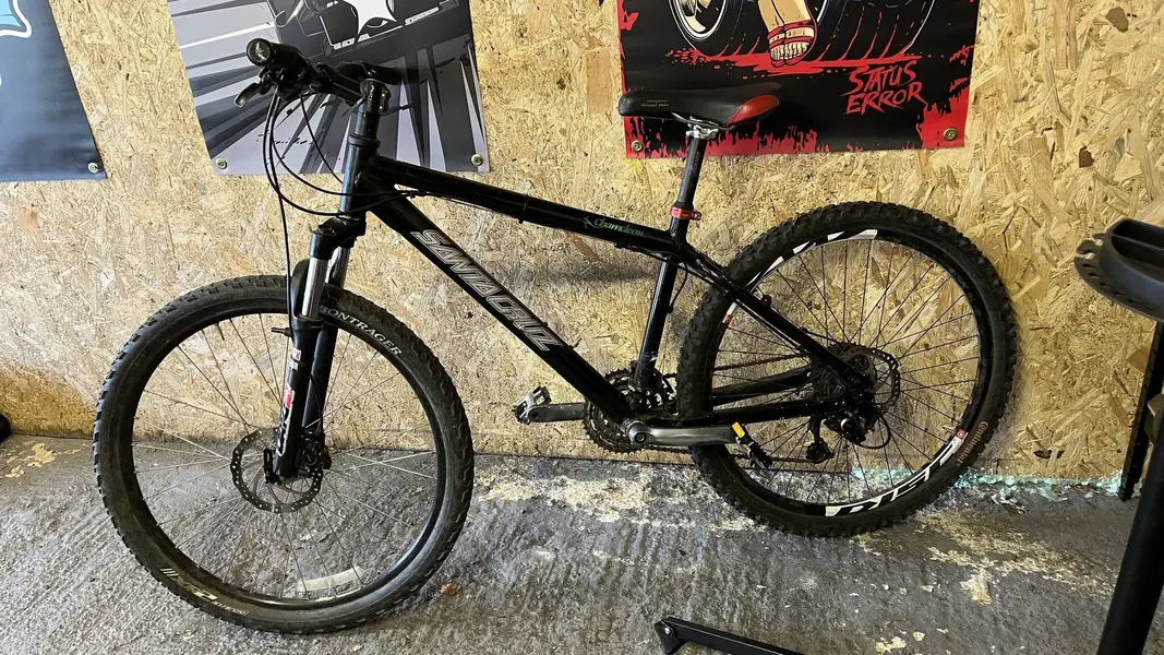

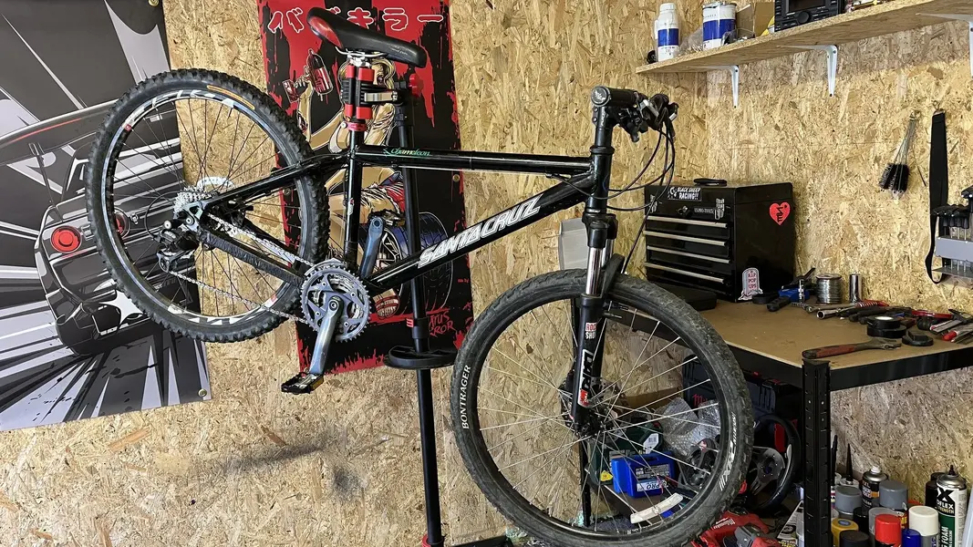

Only a very slight update - picked up a 'donor' bike locally with some slightly more recent XC28 forks as well as MTX33 wheels on Shimano hubs with some fresh Maxxis tyres. Please ignore the dork disc and the old cassette - they'll be coming off shortly in favour of my 1x12 setup when all the bits arrive!

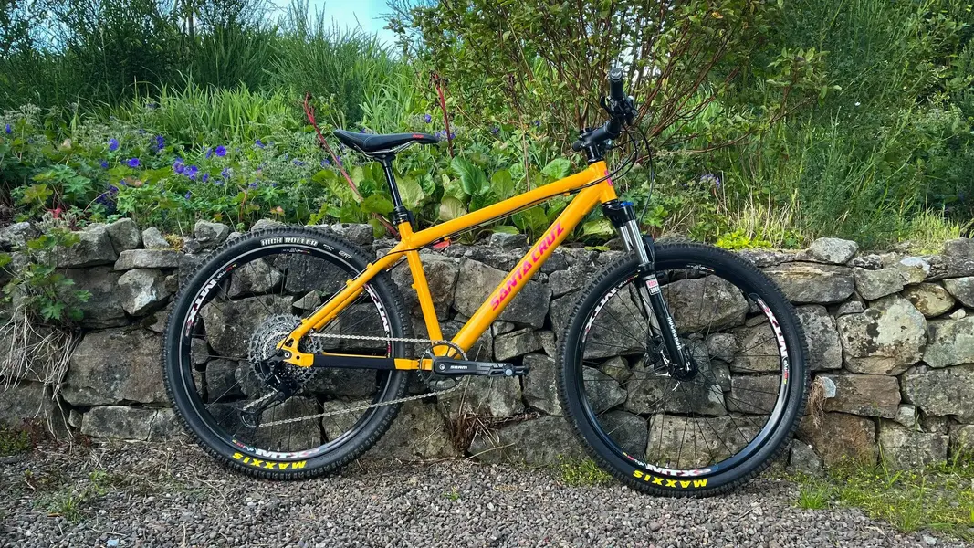

Taken it in today to get the handlebars shaved down a bit and those BB threads chased. Shop seems a bit busy so it likely won't be before the weekend that I get the bike back, but ah well. I'll be ordering the cassette tonight and I think that's it as far as components go - just a few little niceties like a chainstay protector from a Megatower, and then we'll be good to take it out for it's first ride!
Cassette has arrived - the final piece of the puzzle before I can go and ride it! However, the only spacer I have isn't quite right so I've ordered a pack of various widths so I can get that tightened up properly. Mostly posting this because I think a 50t cassette looks ridiculous on a 26 inch wheel :LOL:
Also got a small head badge on the way to replace it with a 'proper' one rather than the sticker, as well as a temporary chainstay protector until my official SC one arrives. Still on the lookout for some better forks, but in the meantime I'm really happy with the cost/spec/etc. of the build so far.

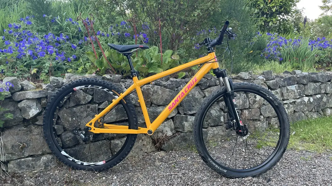

And we're just about done for now. Had a few issues with the lockring on the cassette making contact with the frame, so had to pop a washer on the axle to space that out a little. It's in a state where I can now actually take it for a ride, so hopefully I'll get out on it this weekend!
Future plans will include some fresh, sealed bearing hubs and a nicer set of forks. Gives me something to upgrade later on down the line, though!

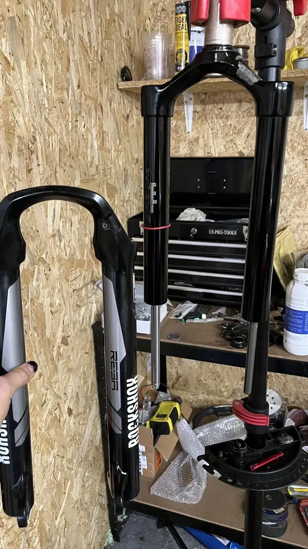

As promised, one set of decent forks (Reba) coming up! Giving them a service and changing the air spring to give 120mm of travel, and finally sorting out some paint damage from previous cable rub! Was quite a task finding something without a tapered steerer, for 26 inch wheels *and* QR.

Rebas freshly serviced, air spring replaced with a 120mm unit and the forks generally tidied up. Downside is... I was a touch off with my steerer measurements and now need a stem with a slightly shorter stack. Planning to order a DMR Defy (50mm) as I fancy bit of a shorter stem on it now that I've been riding with a 70mm anyway.
