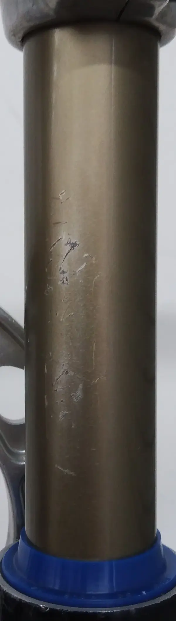

Here's what you didn't see in the previous photos. Surprisingly, it's dead smooth to the touch, it just looks awful. I can't understand how they got this bad, other than the bike was stored badly, or travelled badly, at a point when it was no longer of much value to the original owner. That coating is incredibly hard, (Ti-Nitride?). I'd understand just one or two minor nicks, but for both stanchions to look like this, definitely makes me wonder.
