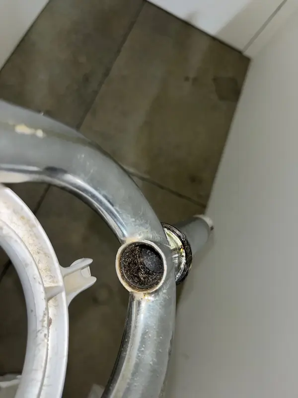

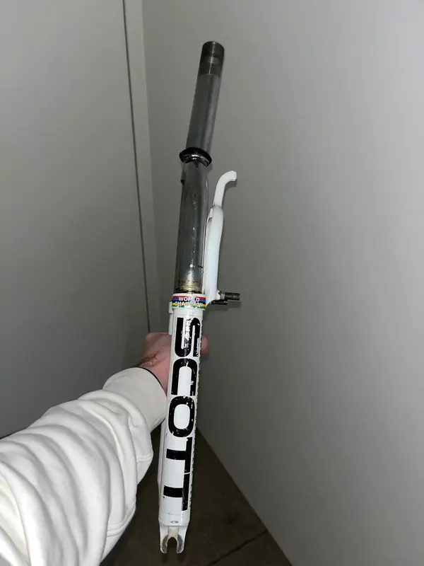

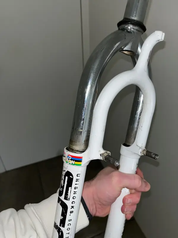

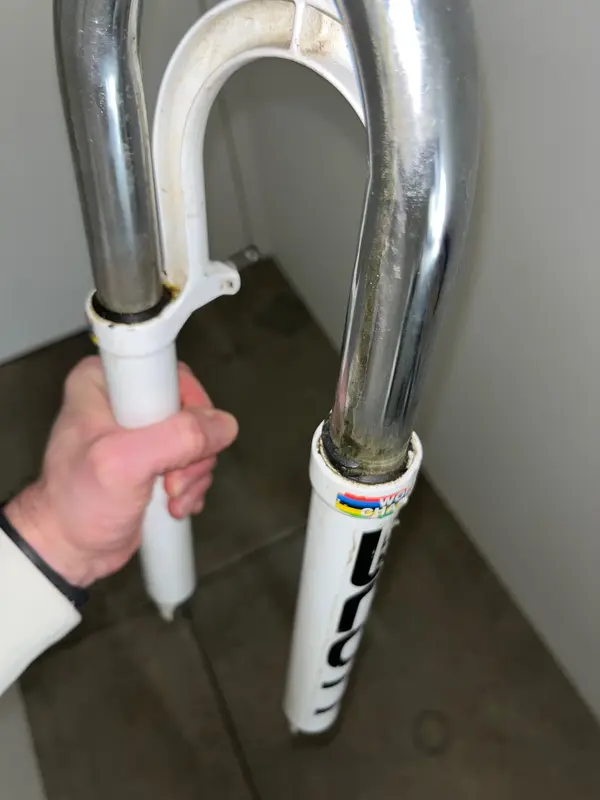

Finally managed to get hold of a Scott Unishock fork.
I was desperately trying to find the very first gen with big "unishock" decal version from 1991 that weren't in the recall, but couldn't seem to find one in 1 1/8" size that i need.
So ended up with a world cup edition unishock. I'm presuming its an earlier version of the world cup edition poss from 1992? as the cantilever mounts only have 1x whole drilled in them. Where the green decal world cup's i see a lot more of online have 3x holes drilled in this area. But if anyone can confirm this, and put a year of production on these forks? that would be amazing.
It's crazy how hard these are to come by and the price they still command especially in the UK, but i guess the huge recall and one's that were not recalled possibly cracking answers that i guess.
I bought this fork as seized / none working / parts only. I've spent days researching these forks. And i know there was a member on here who has re-built a few of these. I screen grabbed his name, so now just need to find that screen grab 🫣 so i can DM him.
I just had a few questions before i start the tear down.
Has anyone ever found (either after market or poss from a different brand of fork), replacement leg seals that fit these forks, these are both shot.

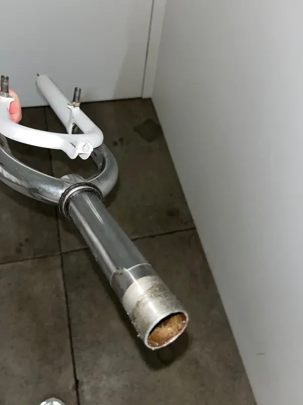

And for anyone that owns one would you please take a quick look up the steerer tube to see if its plugged like this one. I can't tell if it's a metal or plastic plug/cap yet as its covered in grease / grime. Just wanted to check if its meant to be there? or if its has been added.
And if anyone who know these, can you see anything glaringly obvious that looks completely off / dangerous where you wouldn't even attempt to fix it. I know this version is probably included in the recall. So i know most of you will say not to run it. But it was just going to be added to a canal toe path commuter bike that i would never take down a trail & was going to just keep checking it for cracks etc.
Ps if i cant fix it my plan was to run it anyway just as a fixed fork, as i love the way these forks look, with the oversized tubes and massive vertical scott decals compared to the slimmer curved scott OEM forks etc.
Any help / advice massively appreciated as per usual.
