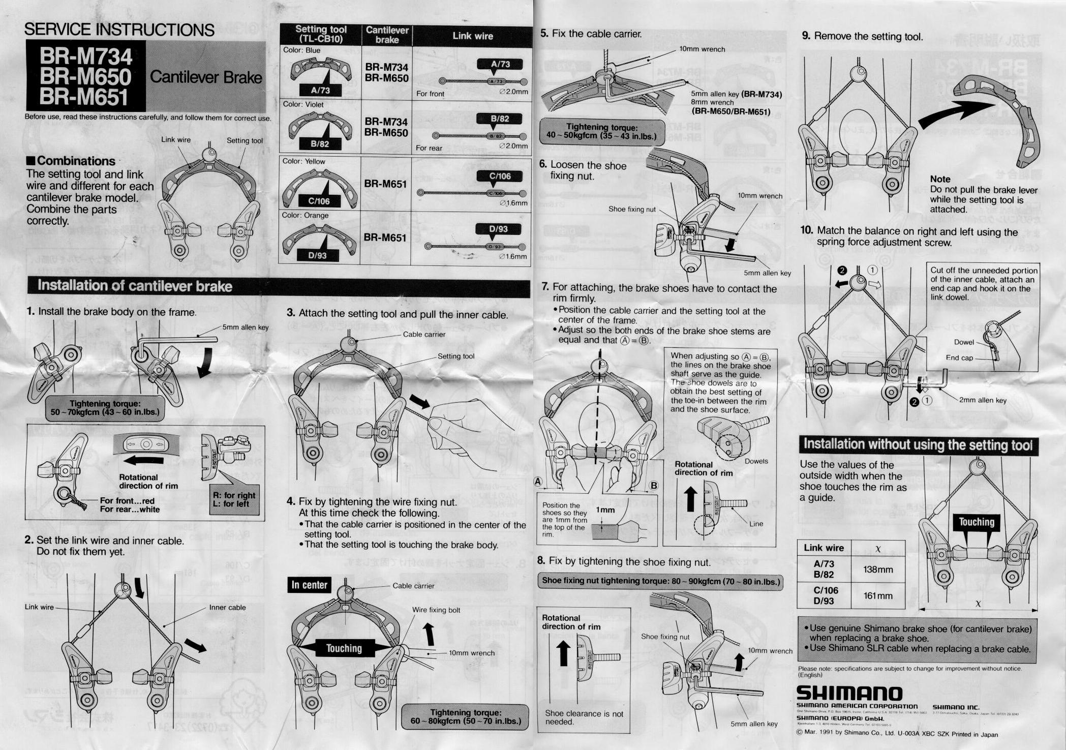

According to the info here you are correct that A is for the front and B is for the rear.
In practice it's often preferable to use as short a straddle as possible to maximise potential braking power.
Also, some Shimano brakes are designed to use different straddle lengths, hence the range of lengths available.
Thanks very much for attached service manual. It helps a lot.
I will check what will fit the best, but probably as I guessed - A for front, while B for rear brake.
