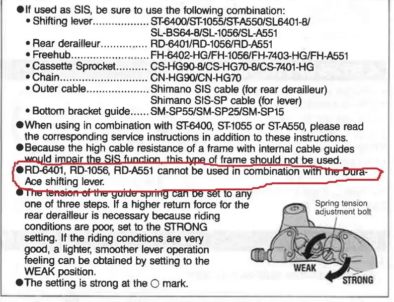

Hi, going through the same, but does anybody know why in Shimano tech specs they say old XT RDs like m735, m739 and even 9 speed 105 RD 1056 do not work with DA shifters ?? (here an example for 1056 but it says the same for old 8 speed XT RD (not for 9 speed ones like m750 and m770)
