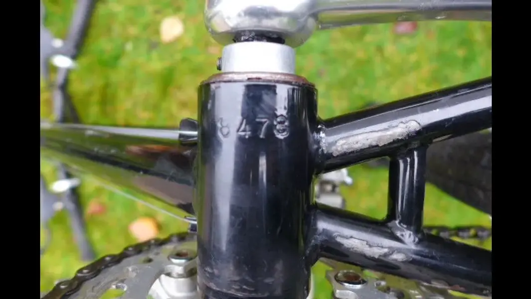

It doesn't really help but here is the bike in question.

No need to make holes surely? To me they are just a way for water to get in.
Why not remove seatpost and turn upside down when you get home from a ride or even store it upside down if possible,
