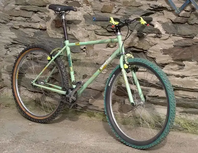

Here's a pic of mine anyway - as you can see it isn't the most "desirable" of machines (just my old '88 Explosif). I'm also lucky enough not to have to use a tensioner too - I just use Sram 8 speed chain and when it's brand new it runs a little tight. One ride sorts that out though and once it beds in it doesn't seem to stretch much. I'm using a 32T chainring (deep tooth, unramped) and an 18T SS sprocket on the back with SS conversion spacers I bought from Charlie the Bikemonger.
Shimano XT square taper BB and Sugino cranks that were originally on my mid 90's Kilauea and tht's about it. Oh, and those very hard to spot Magura Race line HS-33's :lol:
Apologies for the mis-matched tyres too - more minus syle points, I know :oops:

Well, I've owned it since 1989 so I wasn't going to part with it now !
Converting it to singlespeed has given it a new lease of life, as it's a whole different experience. The lightness with all the gearing stuff stripped off is nice 8). I do ride other bikes (with gears !) too, but my faithful old Kona still brings a smile to my face...in fact the very fact that it is older than some guys I meet on rides makes it even better cooler 8) , plus I think it's one of the few bikes that those flouro yellow HS33's look good (well, ok) on.
